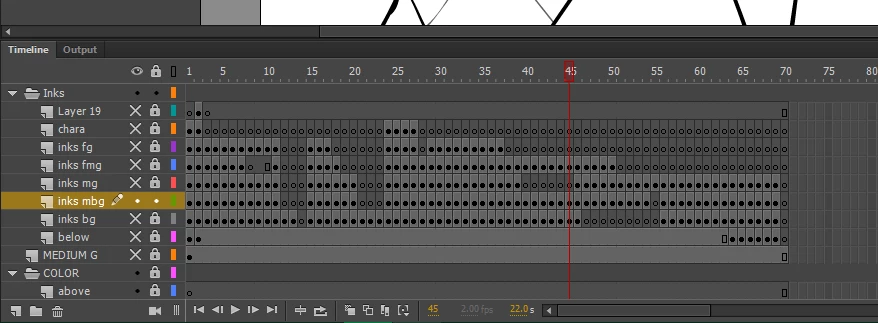

    I have a question that could relate to this. I am currently trying to separate all of my keyframes by an equal amount. I had them all right next to each other so I could work out the key frames of my animation, but now I want to draw the inbetweens, and separating each and every frame by an equal amount is taking a very long time. I was wondering if there was any sort of shortcut or way to insert a set number of frames in between every single frame at once.
    These are my keyframes, and going through and dragging them all column by column is very time consuming. Any help would be much appreciated.
    Thank you.
    August 5, 2017
    That would be a job for a JSFL script.
