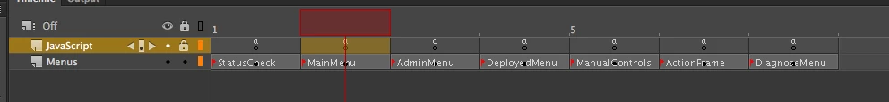

    That sounds similar to how I do things now, except everything is not contained within a single movie clip.
    I have a main timeline, and frame labels for all my frames:
    Each frame is a different submenu. When a button is hit on any of these frames, it uses gotoAndStop(LABEL) to move the main timeline to a specific submenu.
    It sounds like you are proposing I would do exactly that, but inside of a single movie clip.
    Then all my submenus are their own movie clips, on their own frames, and I skip between frames like I do now.
    Is there some advantage to doing that? Does that help with event listeners somehow?
