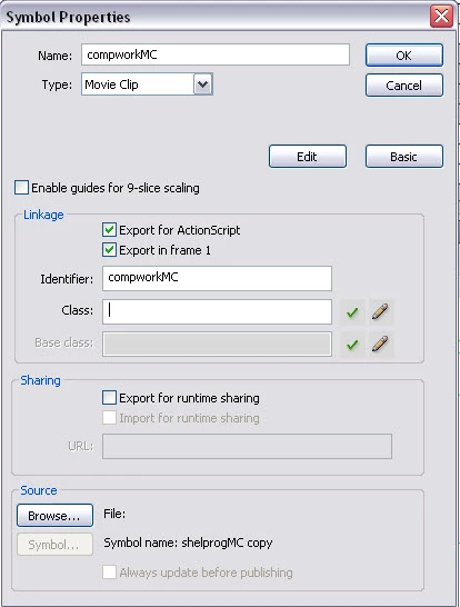

I have a page with about 6 key words over which I will place invisible buttons. First button instance is named compworkBtn. I have a blank mc on the stage, name of mcLoadertop. My mc I want to play is in the library and named compworkMC. I read that I need to set the properties to export and I have done this (picture attached for compworkMC).
