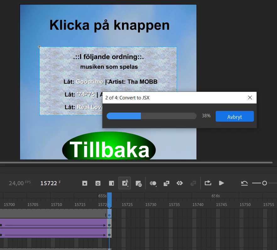

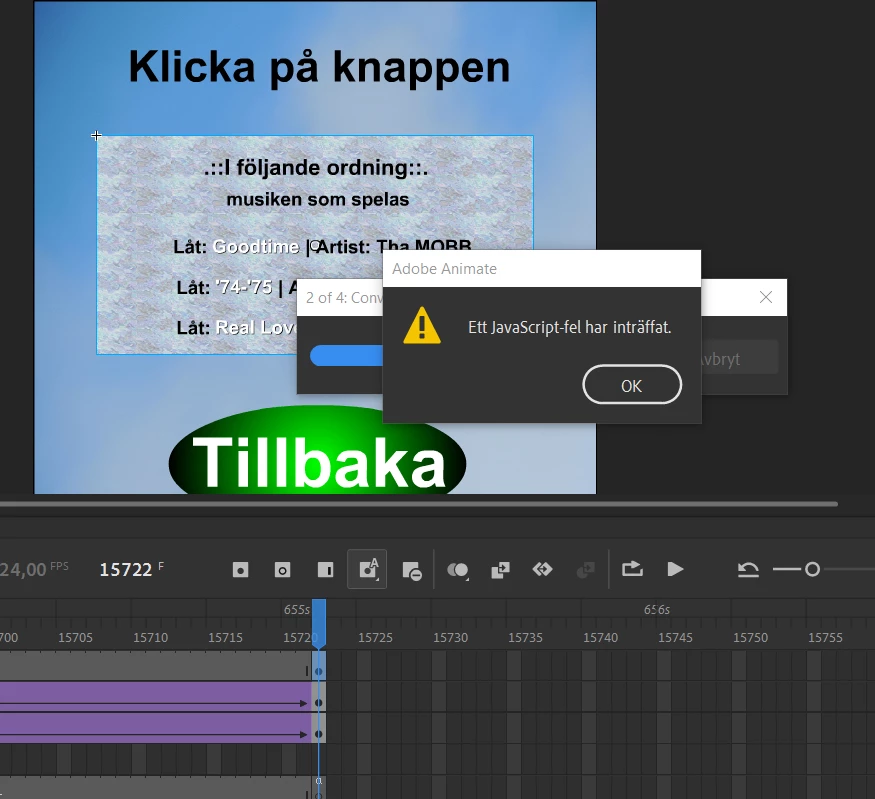

I have encountered a problem in Animate 2023 HTML5 canvas. I have made a slideshow with 100 images and on frame number 15722 I have added a MovieClip object with links inside. When I publish it I get a warning box that says "A JavaScript error has occurred". What is it due to?

16000 is the upper limit for each timeline frame number.

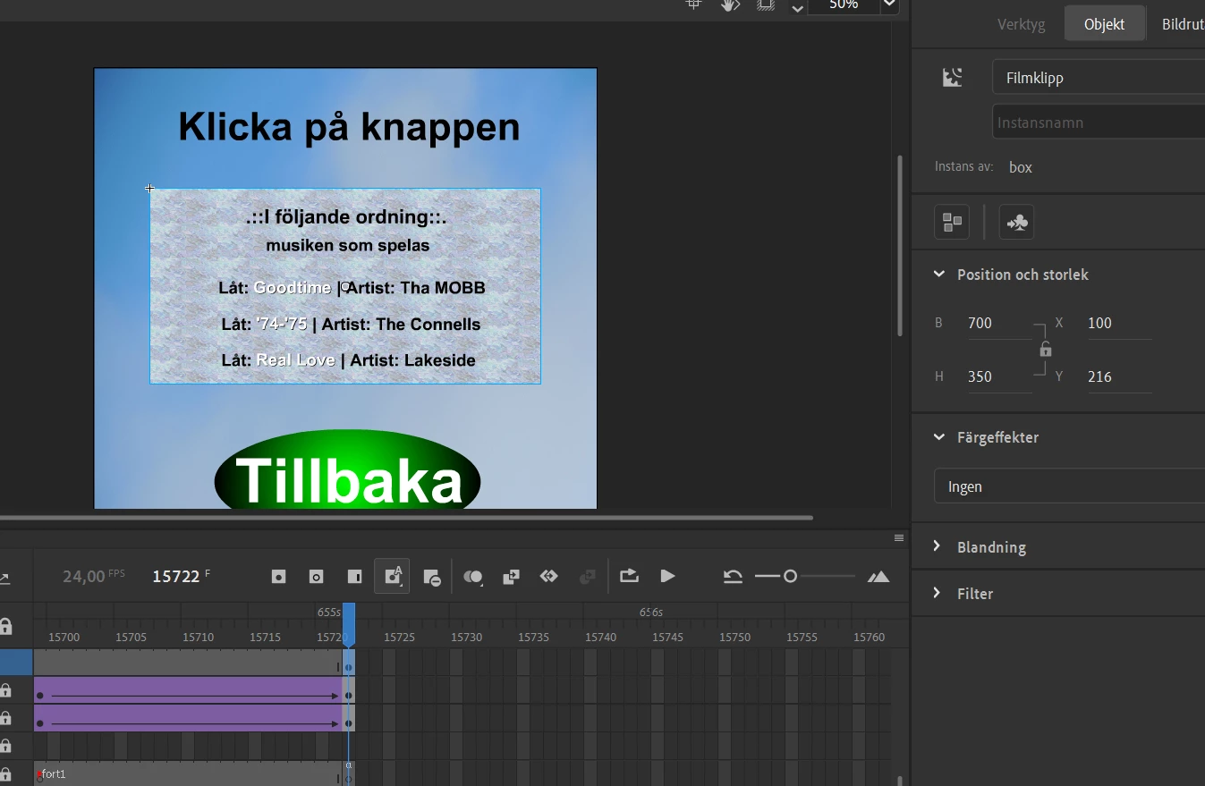

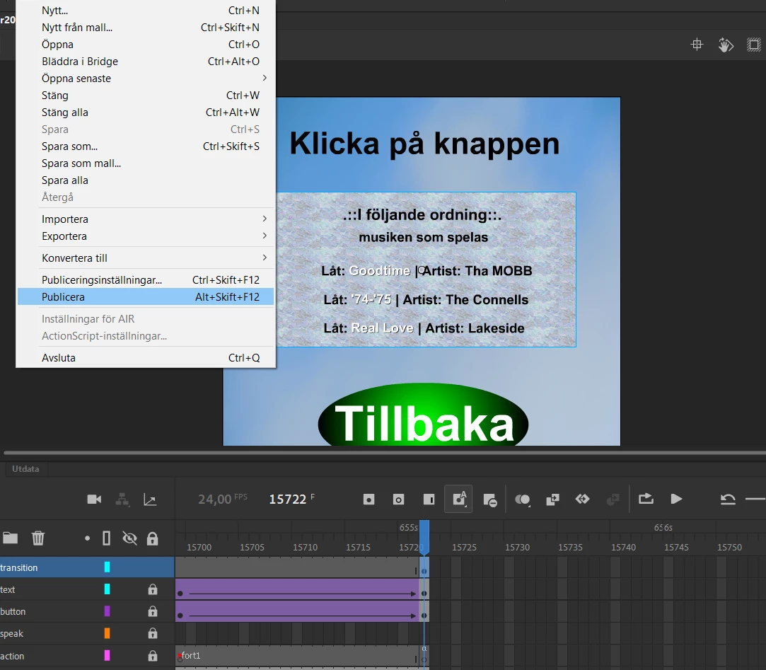

I'm attaching four pictures where you can see. At the end of the slide show, you reach an ending with a box and button. I want that drawer but Why does it say "A JavaScript error has occurred." "Ett JavaScript-fel har inträffat." in swedish. When I remove then works. Is there something wrong with the program or is it something that I have done wrong.

remove 100 or so frames. what happens then?
