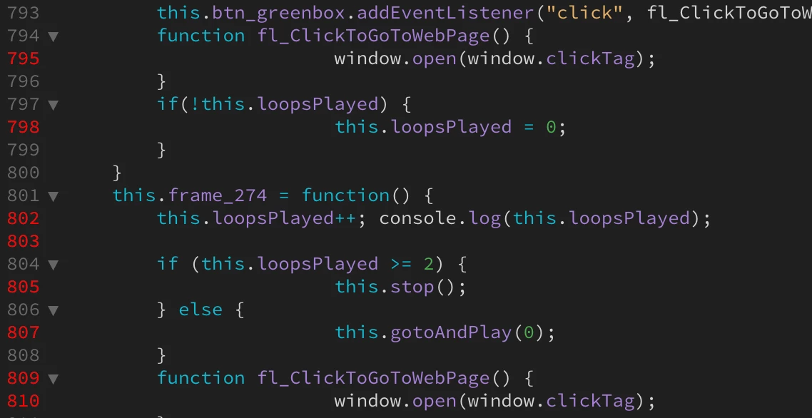

metataqua appears to have an extraneous curly bracket at line 796.

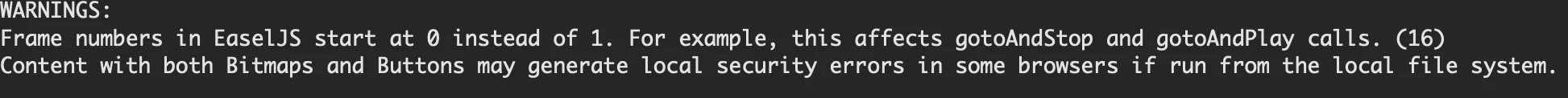

Thank you for responding! I'm new to Animate, so I'm sorry if this is something simple. Animate Output read this after Publishing, and I don't know what it means (particularly the first part):
When I opened the JS file in Dreamweaver, this section was marked with errors, but again I don't know what it's asking me to do:
Thank you for your help!!!
