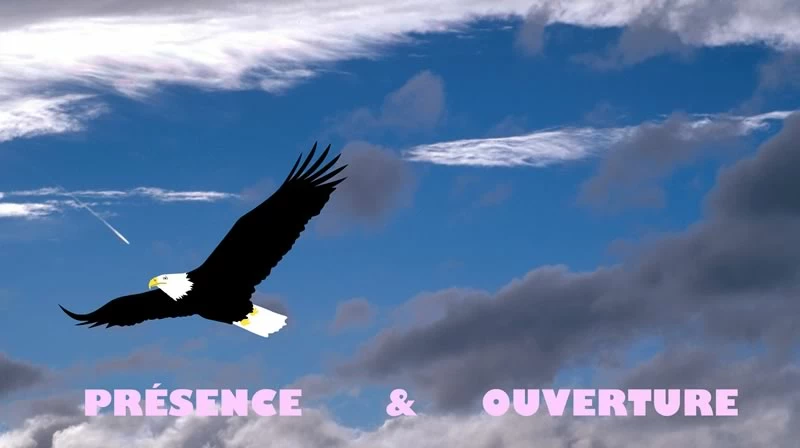

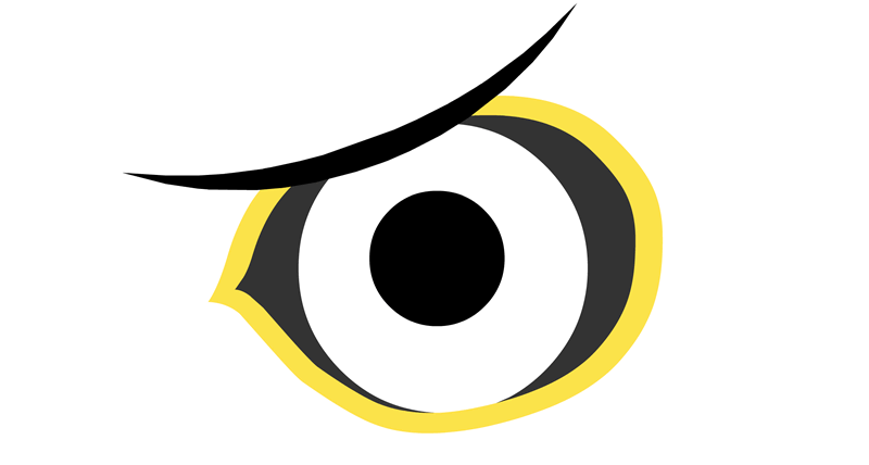

I am animating an eagle illustration. First part is a zoom out tween from eye full screen…
…to head…
…then bird in the sky. Second part is a gliding through the screen.
My problem is that this gliding is jerky. In order to be able to zoom out, the eagle drawing is detailed. So I guess that to get a smooth rendering, for the gliding part I should tween a second clip symbol with a far lighter number of control points. How could I produce this simplified version of the eagle ?
But may be someone has another avenue ? Thanks in advance.

Hi Nick,
Thank you so much for taking time for a so detailed response. I appreciate :-)
the first two images are one shot (zoom out), but then the third image is a second shot.
You zoom out, but then you cut to shot 2 with the whole bird gliding right to left.
In fact, there is no cut. I animate a mask revealing the sky, with a disk centered on the eagle's eye and growing beyond the whole scene.
During this cut you can introduce a different version of the eagle.
Since my first post, I did it. In this clone, I reset the position of the registration point (centered on the eye in the original), as you mentionned that point in another response a few days ago. Unfortunately, same result :-(
How does the jerkiness of the tween manifest itself?
Some kind of ghost image, particularly visible on the feathers ending the wings.
The eagle is a movie clip symbol nesting a graphic symbol for the more detailed beak and eye required for the zoom out part : at the very start image the eagle is highly scaled in. No rotation at all anywhere.
Sorry for the bad tagging : I do use classic tweenings, with a curved path for the gliding. This tweening is about one hundred images long (so about 4 s with default 24 ips frame rate).
playback issues.
Thank you for the temp box trick : same ghost image with a fake simple black rectangle. Surely I am asking too much to the player ! But my intent was a slow gliding movement : the bigger the birds, the slower they can glide. And it's an eagle, not a falcon :-)
consider … resolution of the whole scene
It's huge : a 16:9 of 2000 x 1125, far from the standards with Flash/Animate, isn't it ? But I am not targeting the web directly : this animation is intended as opening titles for a series of videos. But having no experience with After Effects, I opted for Animate.
Two options I considered :
• Reducing the scene to 1280 x 720 : but how to scale a whole animation ? I fear it would imply to rebuild it.
• Only keeping the eagle drawn in Animate and rebuilding the animation in After Effects. But I not even know if everything is possible (zoom out + mask animation + tweening with curved motion path).

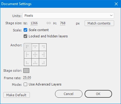

Reducing the stage size shouldn't be an issue, but not sure if it's necessary.
You can do it automatically from Modify menu > Document...
Make sure you have "Scale content" checked before setting the new stage size.
Best!
