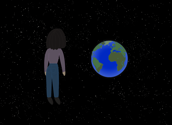

Jerky tween at beginning and ending
I'm new to Adobe Animate and just created my first classic tween. The motion is supposed to smoothly go up and down in a straight line, but at the up and down phase of the tween, it glitches slightly. Anyone with a solution?

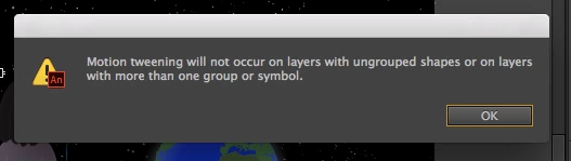

Mar 15, 2019 3:53 PM UTC
The last keyframe is a copy of the first keyframe, the starting point. This last keyframe shows me the warning sign when I add the classic tween.
Mar 15, 2019 3:52 PM UTC
God, I spoke too soon. It's still not working.. It's all 1 symbol.
Mar 14, 2019 8:03 PM UTC
Found this. Looks like it might have something to do with it?
n. tilcheff
Mar 14, 2019 11:05 PM UTC
To use Classic tween successfully you must have only one symbol per layer and this should be the same symbol in left and right key.
Here is how to check that:
Click on each key and look at Properties panel to see the name of the symbol in the key. All 3 should be the same.
You must learn to prepare your symbols in advance, before activating Classic tweens.
First here is how to try and fix this 'glitch':
1. Remove both tweens. Remove the second and third keys from your animation [Shift+F6]. Leave only the first key. Then create new keys again by pressing [F6].
2. Move the character slightly (using the arrow key on the keyboard to make sure you are only moving up) in the second/middle key.
3. Create the Classic tweens again and adjust the custom ease one tween at a time.
More explanations:
If you have multiple objects and try to tween, Flash/Animate wraps them in an automatically created symbols called Tween (with a sequential number).
These are (in most cases) useless.
You can check your Library and see if you have any automatically generated Tween symbols. If you do, this is an indication that you have initiated tween in a key that did not have a single symbol on it - either had multiple objects or shapes.
In the Library you will see how many times your symbols were used. If there are Tween symbols used zero times, delete those.
After 'fixing' the tween issue with the procedure described earlier, there shouldn't be more than one Tween symbol that has been used. This may be what you had in your first key. If there is such, the count should be 3 as this is how many keys you have.
Rename it to 'girl'.
Nick - Character Designer and Animator, Flash user since 1998 | Member of the Flanimate Power Tools team - extensions for character animation
Mar 15, 2019 3:24 PM UTC
I removed the 2nd and 3rd keys and moved the symbol up using the arrow keys. I believe that was the problem. Such a small thing, lol. Thank you all so much for the help!!!!! You guys are awesome.

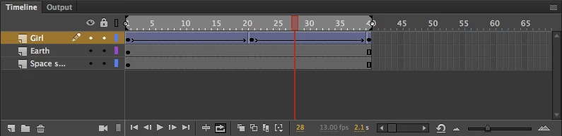

Mar 14, 2019 7:58 PM UTC
Thanks for all the willingness to help!
As you can see, the jerky movement is mainly happening from the up-to-down phase.
Mar 15, 2019 1:19 AM UTC
I would remove the tween and then make sure your keyframes are all aligned with the Align tool. Be sure to select all the frames at once. Then add the tween back.
