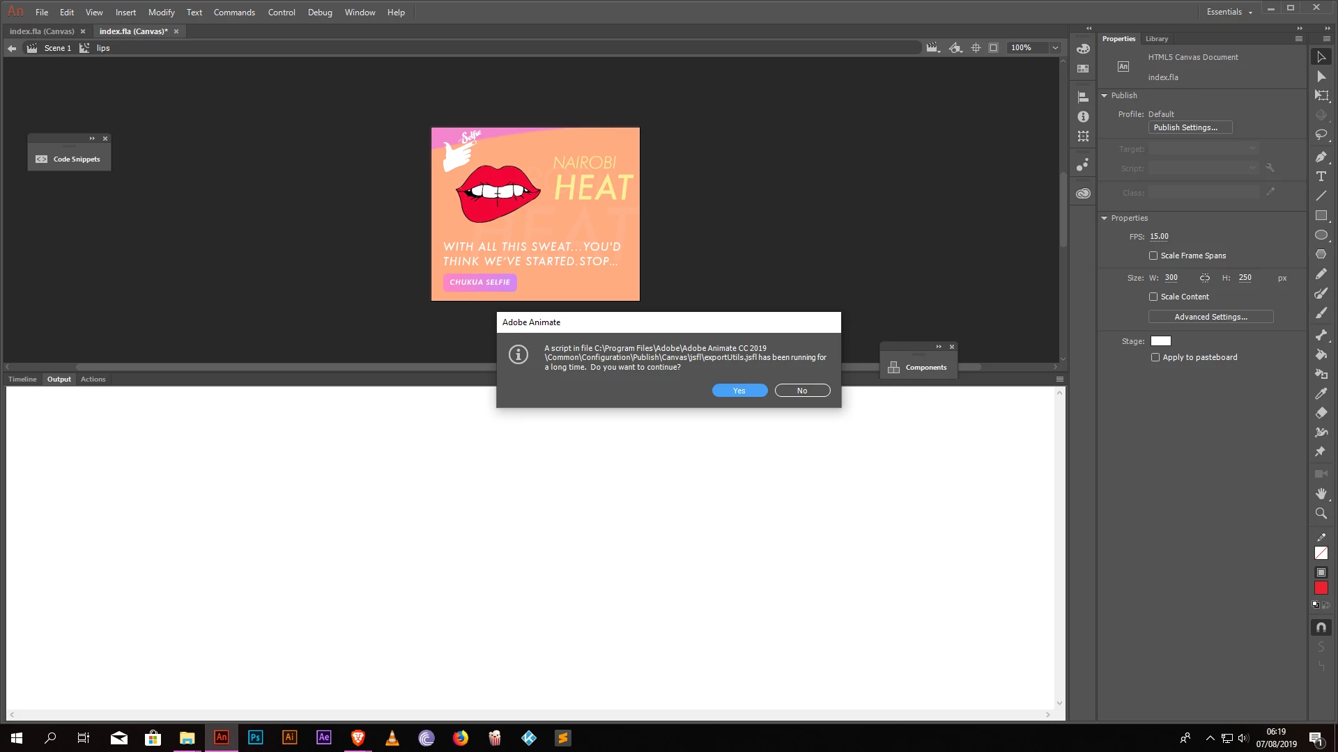

'JSFL script running for a long time' - how do i stop this
does anyone know how i can fix this issue, even when i CLICK yes the message keeps poping up

Hi.
This is probably happening because you're trying to export a very complex project. Meaning lots of complex vector artworks, lots of bitmaps are being generated, lots of shape tweens, and motion tweens. Also these bitmaps may have huge dimensions.

Also, is it possible for you to update to the latest release of Animate CC? It may help.
Here is a screenshot of a complex project I worked this year that I used to get similiar errors like yours very frequently. The errors only went away when I optimized all FLAs.

danielo33771543
August 7, 2019
thanks alot, so what i did i decide to seperate my animate files from 181 frames to 3 seperate animate files. and it worked. The main issue was the complex shapes.
