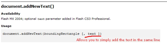

I have a problem with the addNewText() method, because the usage differs between versions 8 and CS3 of Flash, in Flash 8 it doesn't actually write any text.
In CS3, after specifying the size and location of the text field, you can add the text in the same line.
However, in Flash 8, you need to another line to add the text.
Here's the Extending Flash documentation:
CS3:
Flash 8:

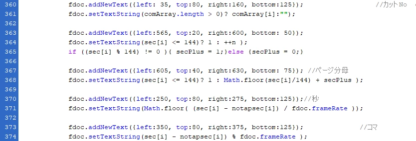

This is a sample of the lines I was trying to edit
I thought if I added the setTextString() underneath the addNewText() it would work,
but I got an error in the output panel.
At line 360 of file "C:\Users\batnab\AppData\Local\Macromedia\Flash 8\en\Configuration\Commands\#Timesheet.jsfl":
            fdoc.setTextString(comArray.length > 0)? comArray[i]:"");
missing ; before statement
This doesn't help me debug, so I don't know how to fix it.

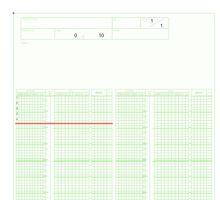

Basically, the function of the script is to get data from the timeline and write them in text boxes on a timesheet.
It looks like this when it works:
However, in Flash 8 it's blank, because it doesn't create any text.

The range of lines with addNewText() I was trying to edit are 360-365 & 439.

I was able to get it working.
My idea was right, just the execution was wrong and I didn't properly copy the text into the setTextString() line. (bruh)
So here's the code

// タイムシート情報記載
    for ( i = 0; i < sec.length; i++ )
        for ( j = 0; j <= Math.floor( sec[i] / 145 ); j++ ) //最低1回はヘッダに記入
            fdoc.addNewText({left: 35, top:80, right:160, bottom:125});
							fdoc.setTextString((comArray.length > 0)? comArray[i]:"");                  //カットNo  comArray.join("/"):"");     if (notapArray[i] == 1)
            fdoc.addNewText({left:565, top:20, right:600, bottom: 50});
							fdoc.setTextString((sec[i] <= 144)? 1 : ++n );                              //ページ分子
            if ((sec[i] % 144) != 0 ){ secPlus = 1;}else {secPlus = 0;}                                                          //丁度フレーム時の調整
            fdoc.addNewText({left:605, top:40, right:630, bottom: 75});
							fdoc.setTextString((sec[i] <= 144)? 1 : Math.floor(sec[i]/144) + secPlus ); //ページ分母
            fdoc.addNewText({left:250, top:80, right:275, bottom:125})
							fdoc.setTextString(Math.floor( (sec[i] - notapsec[i]) / fdoc.frameRate ) );//秒
            fdoc.addNewText({left:350, top:80, right:375, bottom:125});
							fdoc.setTextString((sec[i] - notapsec[i]) % fdoc.frameRate );              //コマ
            tl_Sheet.currentFrame++;

batnab0D44AuthorCorrect answer
Dec 22, 2021 4:32 PM UTC
So here's the code
