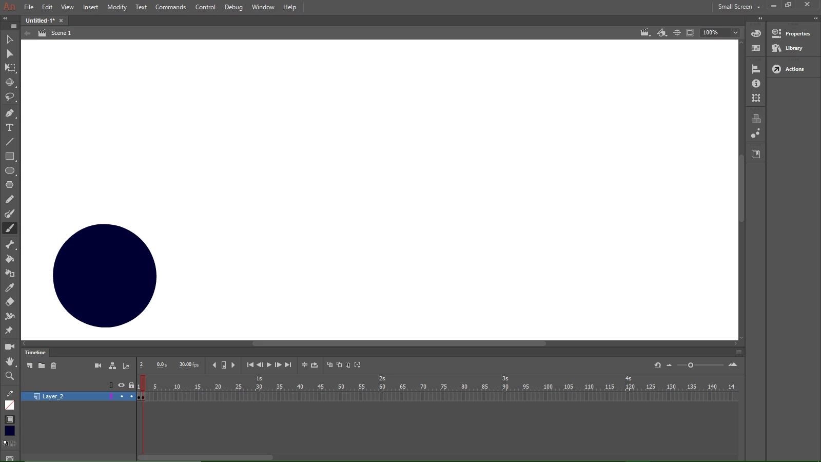

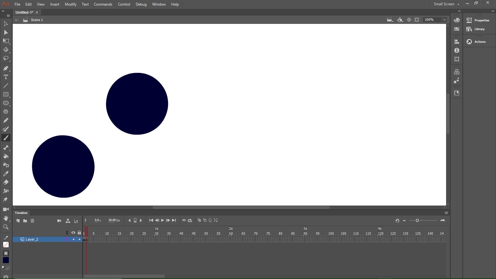

I started up animate and went to work. I made some key frames (all in the same layer) and started to put art onto the frames. I then noticed that my previous frame was still on screen and wouldn't leave. I didn't have onion skins on or anything of the like. I tried playing but it seemed like all my frames were playing as one frame and came on at the same time.
That seems like the most simple way to explain it. All my key frames are acting like they are one keyframe instead of 10 separate frames.
Any help would be great thanks.
_keyframer

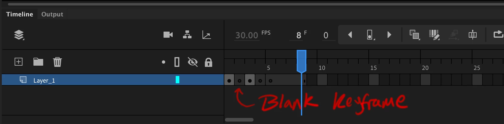

You are using the F6 key. Do not. use the F7 key in your subsequent frames.
Animator and content creator for Animate CC
September 23, 2019
Oh okay. I wasn't oh okay. That is probably it. I hotkeyed the insert keyframe to my tablet and not the other one now that I am using the BLANK KEYFRAME hot key on my tablet it seems to be working. I probably didn't notice it before because I had made a bunch of keyframes at the start before i did anything and then when I went to create more it wouldn't let me.
Thanks. I haven't used flash and an only really starting to use animate so I didn't know there was a difference. Thank you so much for the help. Now I can get back to work without pulling my hair out lol.

Are you 100% sure all of your frames were "keyframes"? keyframes are indicated by a hollow circle (if the keyframe is empty) and a solid circle if the keyframes contains an asset...
