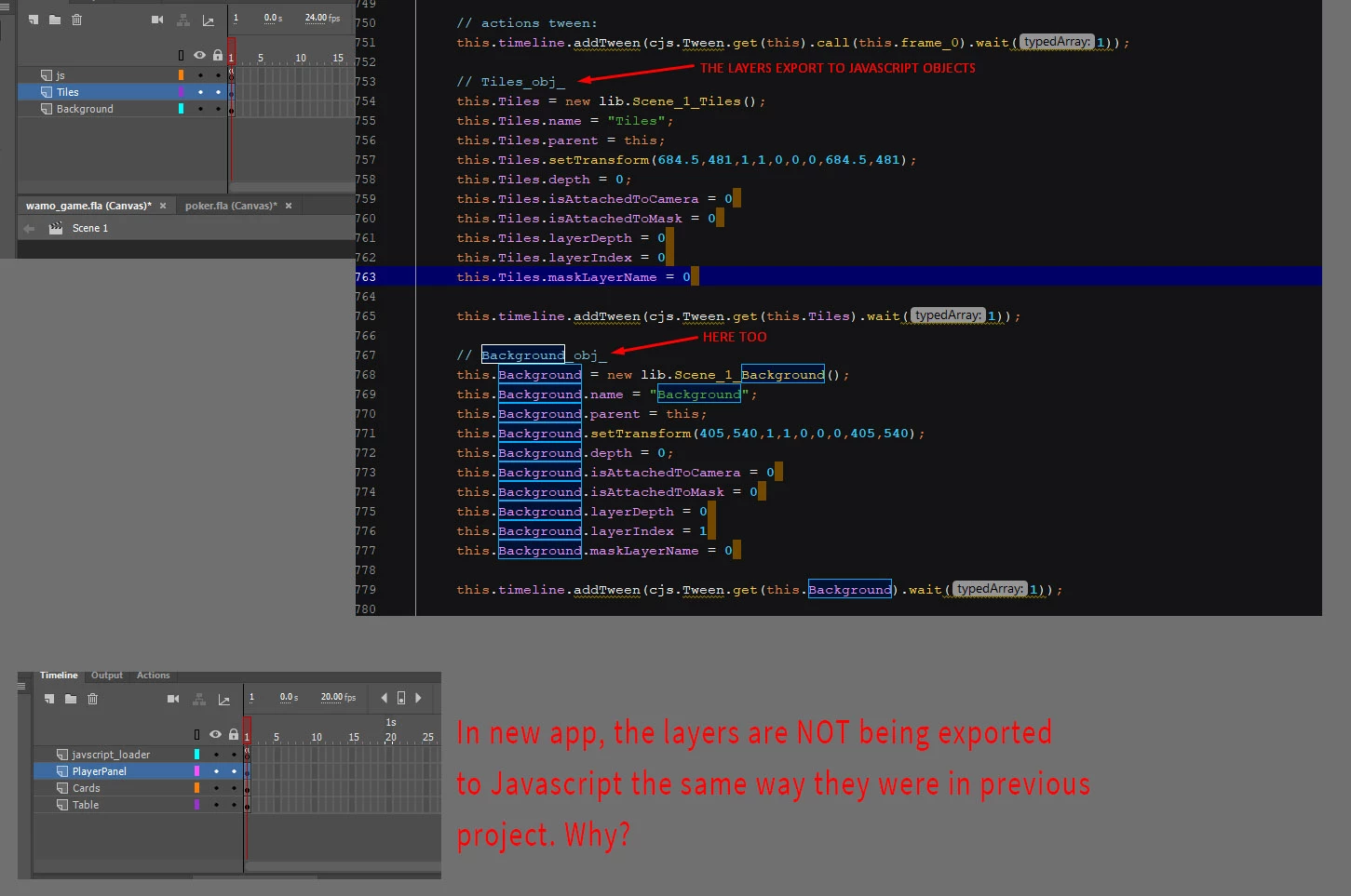

I'm stuck on an issue regarding publishing to javascript.
I have an old animate app I created months ago. In this old app, when I publish, it exports my layers as javascript objects:
I simply don't understand why my old project exports the Layers "Tiles" and "Background" to JS.
But my new project does not! Why?
Correct answer kglad
So, it gets even worse. As a test, I decided to re-publish my old app from months ago. It's checked in to a code repository, so I have high confidence nothing has changed.
However, when I published it again, it ALSO does not export the layers as objects. What the heck changed in Animate?
Why are layers not being exported as objects I can reference in code any longer? This totally broke my old projects.
advanced layers must no longer convert layers to objects.

It's strange that those layers wouldn't export as objects anymore, especially after you made sure that Advanced Layers was enabled.
kglad
July 1, 2019
i don't see a problem in your screenshot.  what problem do you see when testing?
July 1, 2019
The problem, as stated in the screenshot, is the new project is NOT exporting the layers as js objects, unlike the top example where it is.
July 1, 2019
