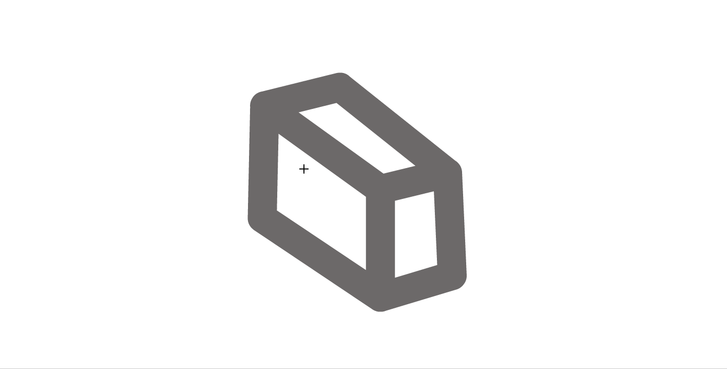

Hi. I have made a cube using the line tool so it looks "3d". I want to animate the cube to make it  look like its turning. I have separated each line into separate layers. I have made new keyframes and moved the lines (changing the position of anchor points) and added a shape tween. Some of the lines now move the way I want them to, but some are rotating before settling down in their new position. Why?

    So... nevermind the wonkiness of the "cube", its a work in progress ,
    but as you can see in the first gif, there´s the rotating error,

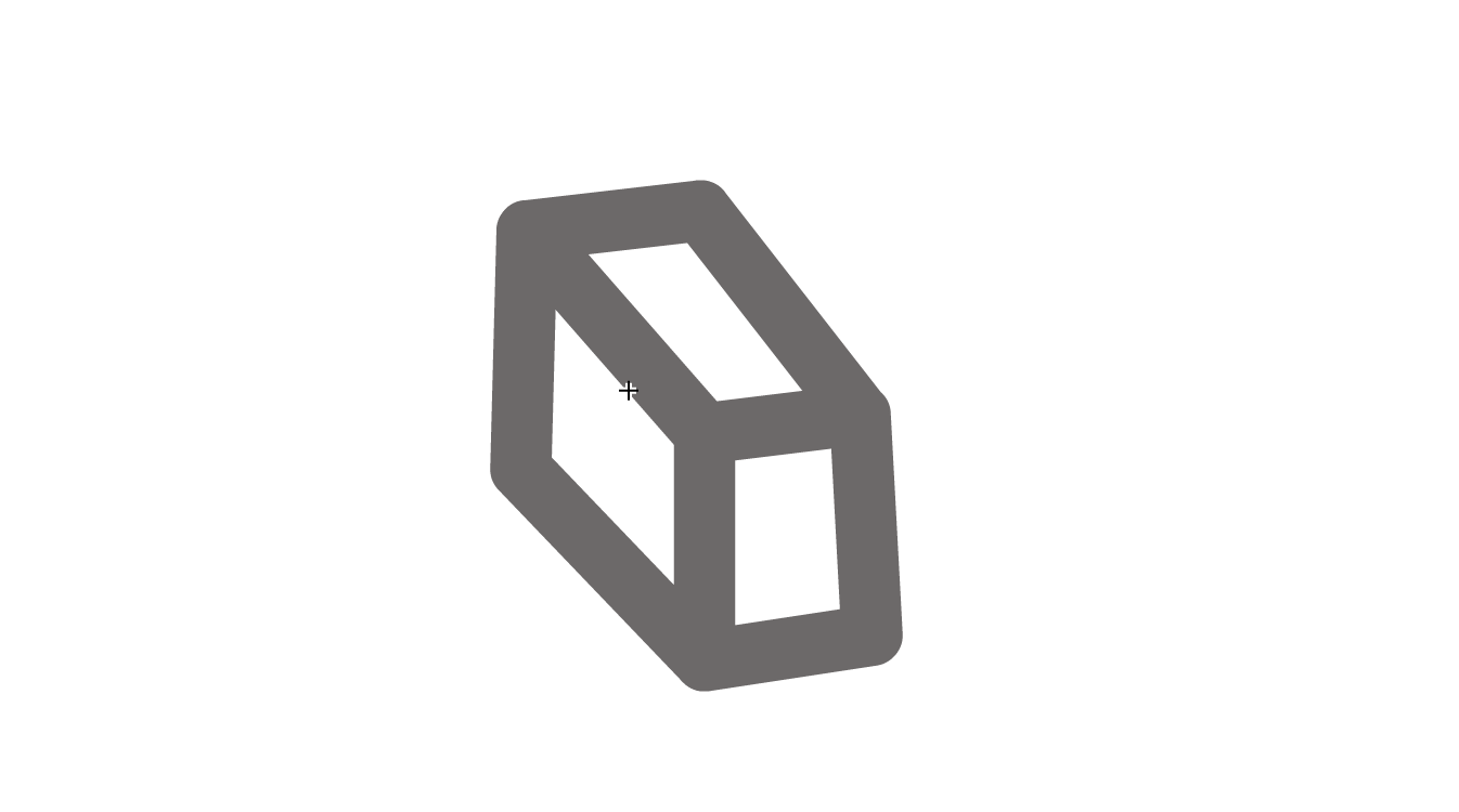

    but in the second gif, where I added a shape hint, the line moves the way I want it.
    So in this case, the answer was shape hints!
    Thank you!
