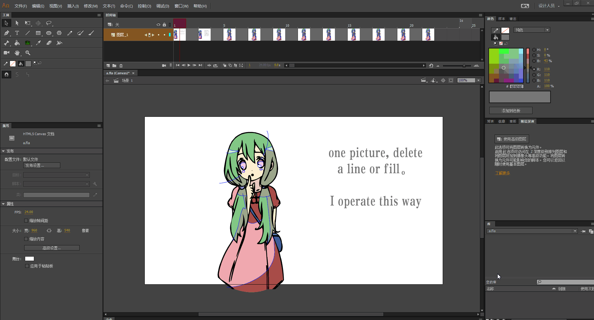

Line segment and color substitution cannot be found..
This is a known bug.
Can solve it with JSFL?
The procedure is
Loop this operation.Next frame, →select all, Line no
The color manipulation process is
Loop this operation.    Get the specified color,color noNext frame,

    Do you need to delete one specific shape color and one specific stroke color in each frame?
    chenjil43641795
    April 26, 2018
    yes.
    Like red, yellow and blue on the screen.
    I only remove the yellow.
    Each framework does this

    I try to JSFL。
    I know the color is fl.getDocumentDOM().setFillColor(null);
    Also know the replacement。
    But I don't know how to specify the color to find。

    Find & Replace
    But the stroke color is not found.
    Fills can replace colors, but cannot be replaced with empty.
    But toolbars are OK。
    But it's tiring to handle multiple images.
    So I need to be able to batch process
