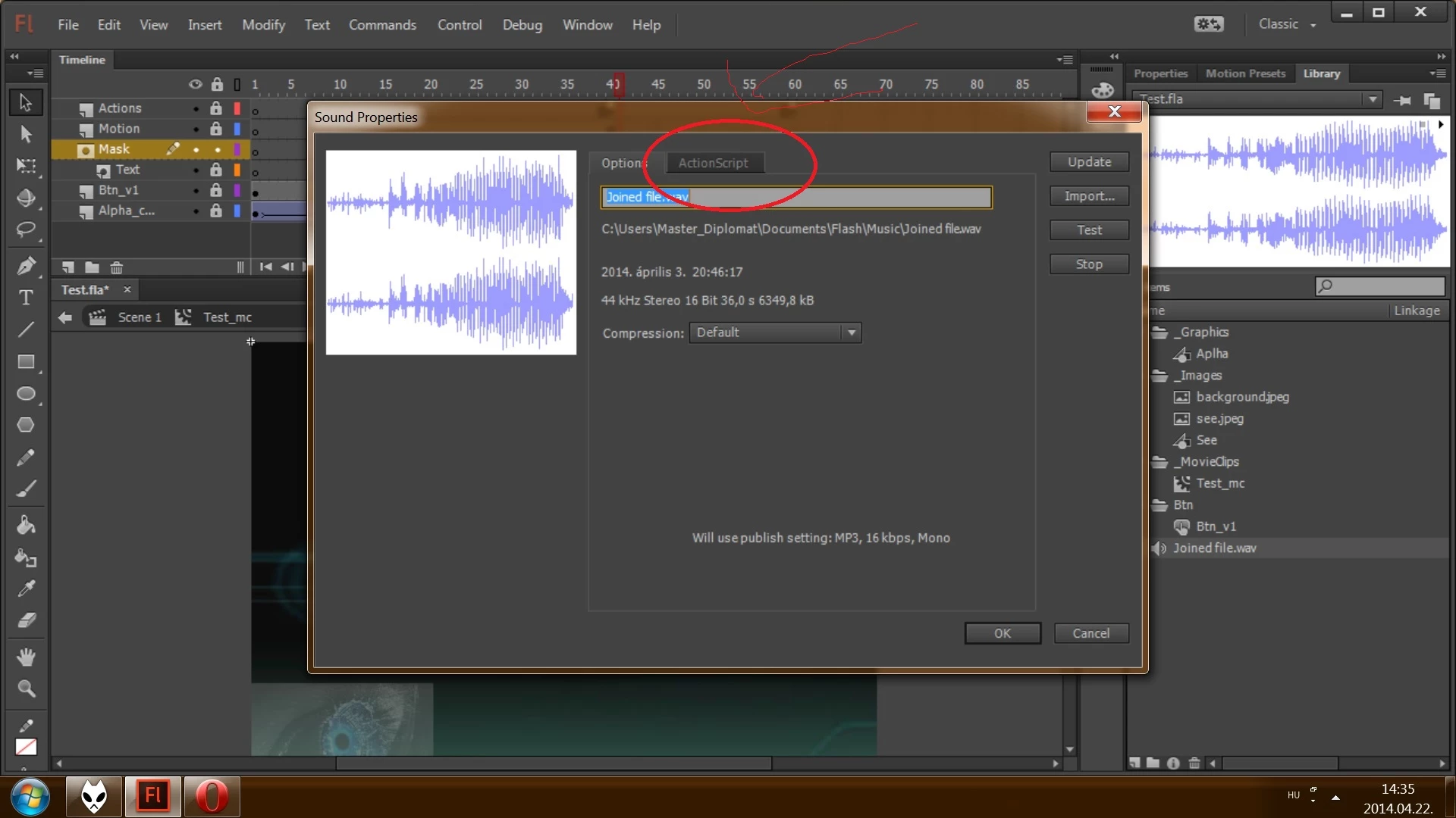

i have an issue, maybe i dont understand the process well.
- I imported a short mp3 in flash cc library.
- I try to linkage it to actionscript, but i can' t.
- If i click on the sound file, and choose properties, there is no checkbox to export for actionscript.
I see an actionscript tab, but i can' t reach it. I can' t click on it.
- How can i solve this issue ?

May 18, 2014
I'm having what might be a similar problem.
It isn't about what file type... but the fact that the "ActionScript" tab in the Sound Properties modal is inaccessible.
I can see the tab change to it's rollover state when I mouse over it... but clicking it does nothing... and as the original poster said... you can't tab to it either.
This is one of may similar issues I'm coming across with the Flash CC IDE interface.
Does anyone know what's up?
kglad
May 18, 2014
what are your publish settings?
if you're publishing for html5, you can't link anything.
May 18, 2014
Publishing to SWF.
If I open the file in Flash CS6 I can get to the tab and set the audio settings just fine.
For some reason this tab is broke on Flash CC.
Any thoughts?
kglad
April 22, 2014
convert to an mp3 and import.
April 22, 2014
i converted, the same window pop-up, but i still can' t reach the actionscript tab.
I can' t click on it, and using TAB on keyboard  i can't reach it neither.
kglad
April 22, 2014
actually, it should work with a wav file, too if you're publishing a swf.  what are your publish settings?
