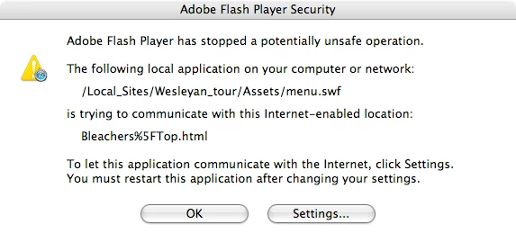

I get this error when i try it, does this mean it is a flash player setup error in that case does anyone know another way to do this because I don't want people to have to alter their Flash security options when they view it.

Same code, just a relative url...
navigateToURL(new URLRequest("Bleachers_Top.html"));

The url you show is not a valid address as far as I can tell.  If you are going to use the http://, then you also need to specify the domain... http://www.somesite.com/Bleachers_Top.html
If that web page is in the same folder as the page your Flash file will be in then you can just use the web page name without the http:// portion.
