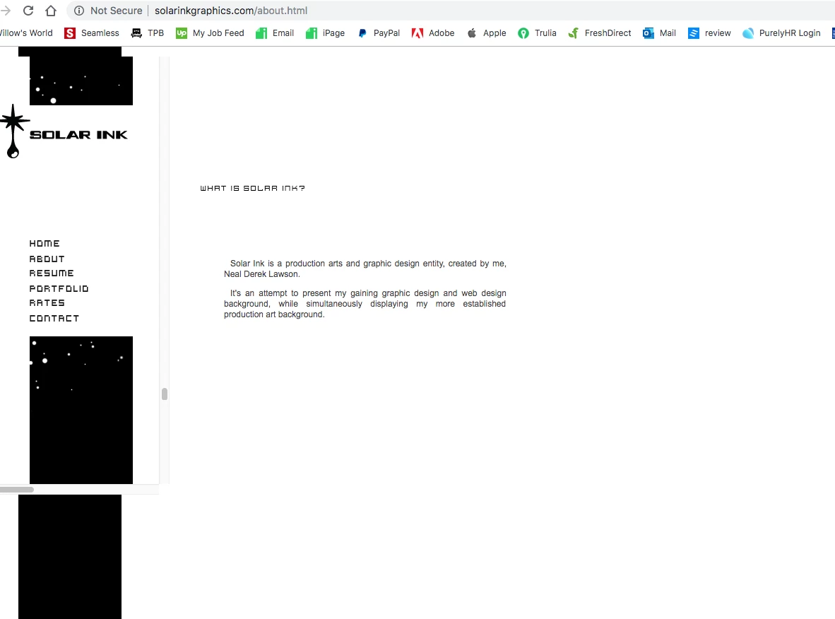

The below code is a sample of how I’ve set up my link buttons in my HTML Canvas file.
I then publish as a OAM file. Then I insert the OAM into Dreamweaver.
Then publish out of Dreamweaver and/or Put up onto the actual server.
Originally the _blank were _self (also tried _parent and _top), all of them (_self, _parent and _top) kept erroneously opening in a frame (image below)?
Why is it behaving like this, when my old SWF site only used _self it worked perfectly (when Flash is enabled of coarse).
_blank is used now only because the others won’t work, but I would like it to behave like it used to, where it would stay on the current window/tab?
What am I doing wrong?
The files I’m using are available for download below.
Thanks.
_self, _parent and _top causes the urls to load in a separate frame?
Sample of my current link setups (originally it was _self😞

According to the source code of your 'Dreamweaver file' your Animate Canvas file isn't located in a frame (like in iframe), it is put into an <object> element by Dreamweaver.
<div id="aboutHead">
  <object id="EdgeID2" type="text/html" width="602" height="260" data-dw-widget="Edge" data="animation_assets/about_HTML5 Canvas/Assets/about_HTML5 Canvas.html">
  </object>
</div>
An <iframe> is its own window object and target attributes like _self, _parent or _top would make sense. An <object> element on the other hand is no window object and, anyway, I don't get your statement:
What are you talking about? In your above HTML document there's nothing being either a Frameset/frame (forget this immediately it's depricated in HTML5 since years) or iframe. I guess that all ill effects which look like 'opening in a frame' are actually caused by CSS positioning problems.

Okay I hear what you’re saying.
This has nothing to do with frames and is most likely caused by Animate button coding, i.e. window.open(url), or Dreamweavers <object> tag.
I attempted your suggestions, coding my Animate HTML5 buttons like so:
this.nContact_btn.addEventListener("click", fl_ClickToGoToWebPage07);
function fl_ClickToGoToWebPage07() {
window.location.href = "http://solarinkgraphics.com/contact.html";
But the same issue continues, where it’s opening in a mini window, within the current window, with its own scrollbars and everything (Isn’t that how frames behave? If it’s not a frame then what is it? Or what is behavior like this called?).
Then I attempted changing Dreamweavers <object> tag containing the HTML5 Canvas animation composition to a <div> with no success, this time it simply didn’t appear on the published page.
