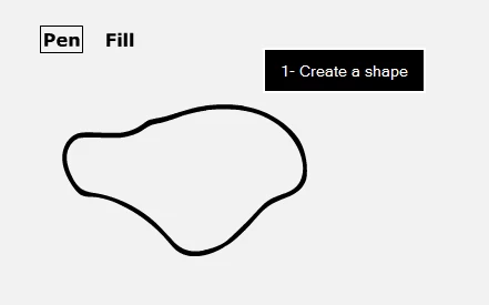

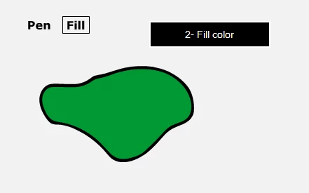

I am wondering is it possible that we can create a shape with mouse then fill color with mouse in canvas.
I am not talking inside animateCC app but in exported animatecc canvas file.
Thanks
