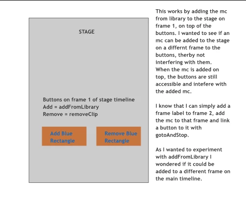

    Haha yes sorry my communication of what I'm experimenting with isn't too clear.
    I'll atempt to explain, with a diagram:
    background info:  you can always diable a button by:
    1. assign its visible property to false (eg, this.buttonAdd.visible = false; )
    2. remove its event listener (eg, this.buttonAdd.removeEventListener("click", addFromLibrary); )
    3. remove the button from the display (eg, this.buttonAdd.parent.removeChild(this.buttonAdd); )
    now, if you want to add something from your library to the stage (assign it a linkage name  - eg, mcID) at a certain frame,  add code at that frame:
    var mc = new lib.mcID();
    this.addChild(mc);
    if you want the code to be on one frame and add the symbol to a different frame, you can use that code in a button listener (if that's how you navigate to that other frame) or you can start a timer loop and check if the playhead's entered that frame and then add the symbol (and stop the loop).
