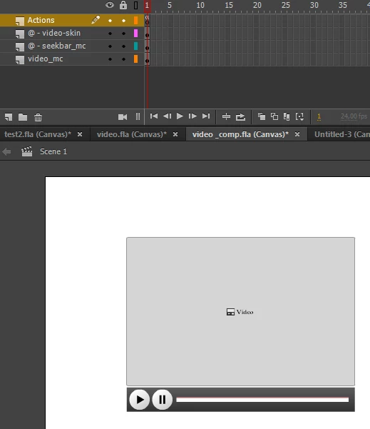

Hi to all,
I try to use the video component, I need assign the path from code... I tryed to use the Snippet Code:
$("#video_mc").src ="videos/video.mp4";
It isn't work... I don't understand
Correct answer ClayUUID
I swear the Socratic method is more headache than it's worth anymore. Let me rephrase that imperatively:
DO NOT put your code on the same frame the component first appears. Put it on the next frame.
August 28, 2017
I assume you didn't put that code on the same frame that the component first appears on the stage.
August 28, 2017
What do you mean?
My code is on the first frame, and the component in int same frame three layer below
ClayUUIDCorrect answer
August 28, 2017
