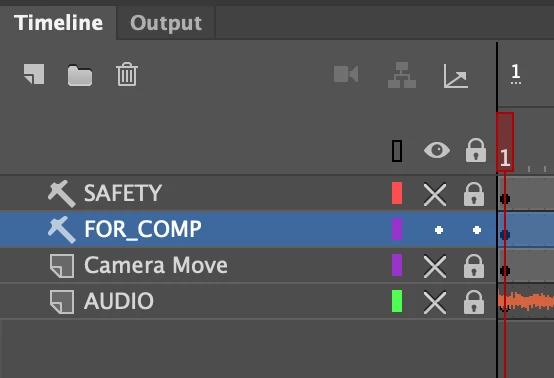

If you need a little more info, the top level of the FLA is set up like this…
The characters are nested inside this guided "FOR_COMP" layer, so I must enter that layer to access the characters. The 'Camera Move' layer is the same as FOR_COMP but with a camera move baked in for the animator to use as reference – I ignore this. Ideally the script would guide every layer here too, except for "FOR COMP", but I don't mind doing this manually.

you can use this jsfl to convert all locked layers to guide layers and publish the swf which should abbreviate your work to 4 clicks:
var layersA = fl.getDocumentDOM().getTimeline().layers;
for(var i=0;i<layersA.length;i++){
if(layersA[i].locked) {
layersA[i].layerType = "guide";
fl.getDocumentDOM().publish();
