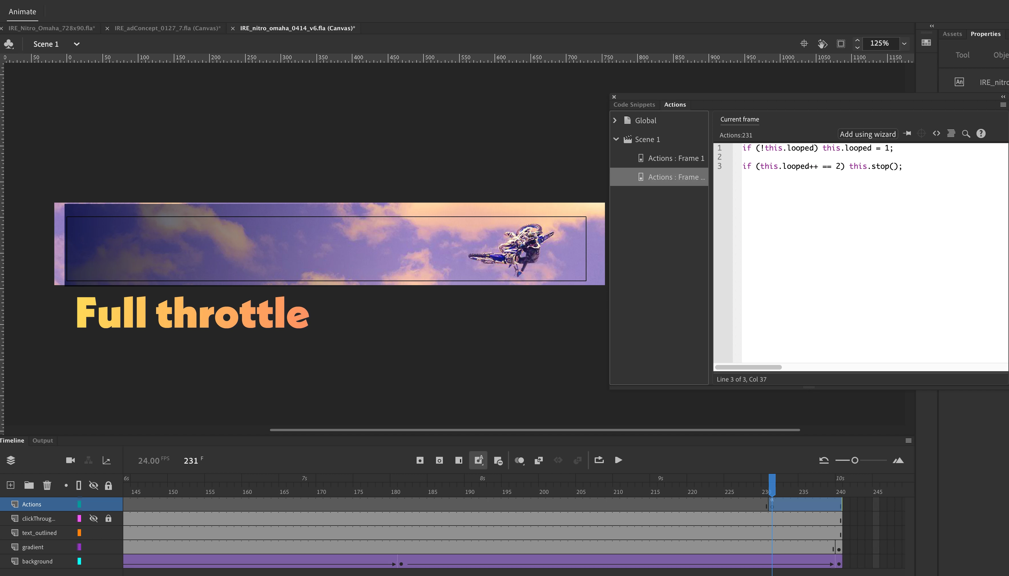

New to Animate, very new to JS. I've built a banner ad in the HTML5 Canvas, but I feel like I'm missing something obvious. Based on this thread, I applied the following code to the frame where I'd like my animation to stop after looping:*
if (!this.looped) this.looped = 1;
if (this.looped++ == 2) this.stop();
I applied the action at the top level of my .fla (I have several nested movie clips and would like all to stop on a specific frame). For a while I thought it wasn't working at all, but now I see that the stop action is only effecting my background layer (not any of the other movieclips). Can anyone help me understand how to get EVERYTHING to stop simultaneously? (see image below)
*I would actually like to loop the animation 3 times and have it stop specifcally on frame 231 of 240, if that information is useful. I just figured I'd try the code above to start

OK, I think follow what you're saying. That still didn't work, but I think I understand why: It's because my movieclips technically *aren't* on frame 231 of the main timline (right?). Those movieclips only appear on frame 1 of the main timeline (everything else on the main timeline is just frames)*, so I need to go into each movieclip and insert the code snippet where I want each of those animations to stop. Is that correct?
For example, a movieclip that is on the "background" layer (motorcycleBG_mc) contains three additional movieclips for the animating circles. To get these to stop, I had to paste your original code snippet within the "motorcycleBG_mc" movieclip
*It's also entirely possibly that I built this whole ad not using best practices. Still learning!

Thanks for the help! But alas — I applied this code, and got the same results. The only thing that stopped was the background layer. (see screencap here)
I had been looking into this thread and wondered if I needed to specifically add a stop for each movie clip instance (which seems tedious and like it's probably not necessary, but what do I know). Thoughts?
