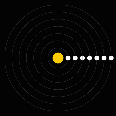

Colin, This sounds like what I need, but it is not working. I have seven planets circling a star and I need the inner planets to orbit faster than the outer planets, yet all twirl around at the same speed. I can't adjust the number of frames because then the fast planets disappear while the slow planets trudge their way around the sun. I tried writing the this.framerate=5; code but the only place I can find to do that is by double clicking on the movie clip and then right clicking on frame 1 inside the movie click to bring up the Actions panel. In Gory Greg's answer, he says to put the code outside the movie clip. Where? I don't see anyplace to use the Actions panel except inside the movie clip. Do these planets need to be graphic symbols instead? Is what I want to do even possible? Thank you for any help you can give me.

    Hi.
    Here is a suggestion.
    Probably not what you want but at least it will give everybody a starting point.
    My setup didn't require code.
    I created 7 graphics for each planet and put them in separate layers in the main timeline. All layers have a duration of 36 seconds minus 1 frame in the main timeline.
    Then inside of each Graphic containing the actual planet animation I extended the child timeline to a number of seconds that when divided by the total duration of the main timeline results in an integer number. In this way all the animations can loop seamlessly.
    To rotate the planets I simply moved the Transformation Point to the center of the stage and set the tween to rotate CW.
    And finally each planet also has a 360 degrees rotation animation of one second.
    I hope it all makes sense and that it can be useful for all of you.
    Regarding to Dreamweaver, export your animation as a OAM Package and you should be good to go.
    For responsiveness, the best you can do is to use the options available in the Publish Settings.
    Preview:
    FLA download:
    animate_cc_html5_planets_orbiting.zip - Google Drive
    JC

    JC, That is exactly what I want to do. And cool, you even rotated the planets as they revolve around the sun. I also appreciate that you included the file you created. I will definitely look at that. It's amazing how fast a brain can delete information if it's not used. Like a hard drive. How long since I worked in that file? Ten years? Ah, delete it. Because of the help you and Colin have given me, I can now finish this job! Thank you.
