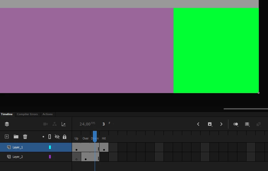

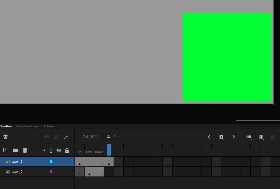

    If you don't want or can't add a listener to the stage or canvas, the only workaround that worked for me and that's easy to apply is to go to the Hit frame of the button and remove 1 pixel in each side of the shape that works as the hit area. In this way the mouseout event will be fired even if the appearance doesn't suggest it.
    I know this isn't the ideal solution, but it may be justifiable compared to a complex setup for such a simple interactivity.
