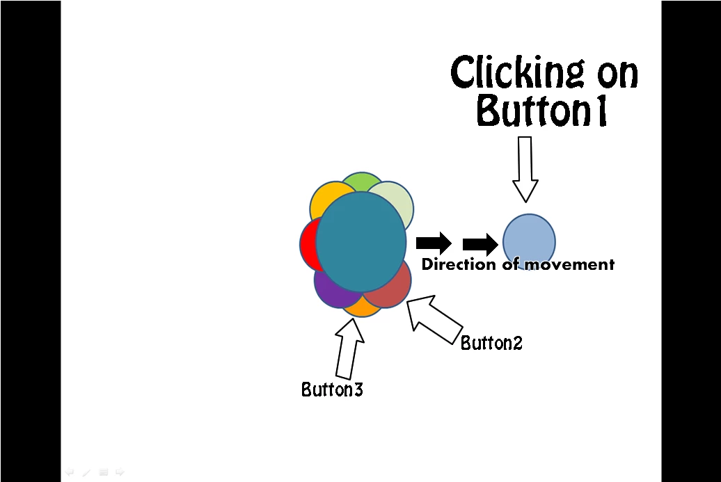

This below helps illustrate what i am aiming to create, for example you click on button1 and then button1 moves from 1 spot in a horizontal direction to another, and click on button1 again it will move backwards, to its orignal pos. Needing advice on this..
Can any1 please suggests any tutorials good sites.
Many Thanks
