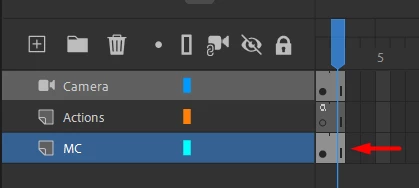

To illustrate how crippled things become when having 'Advanced Layers' turned on, consider this simple example with 3 Layers (Camera, Actions, Layer with MovieClip with 60 frames of animation):
Export and play the HTML5 Canvas and observe the MovieClip playing continuously in a loop.

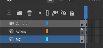

Now, add a blank frame in the MC Layer:
And suddenly the MovieClip doesn't play anymore...

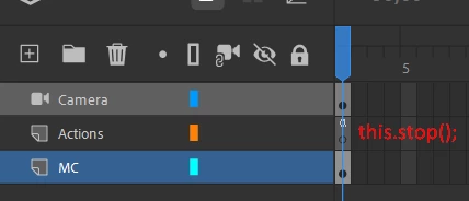

But if you instead only extend the MovieClip frame, like this:
The MovieClip plays after all (remember the code applied on Frame 1: `this.stop();`).
The same thing happens with frames that aren't placed on Frame 1 -- if they span a single frame's length, then they'll be stuck on their internal first frame (in 'Advanced Layers' mode only) until the frame's length exceeds 1.

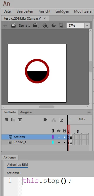

Here is a screenshot of my 2 test fla files
