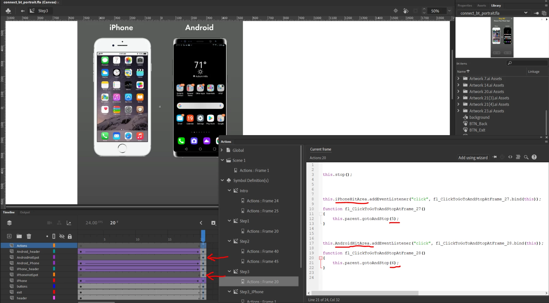

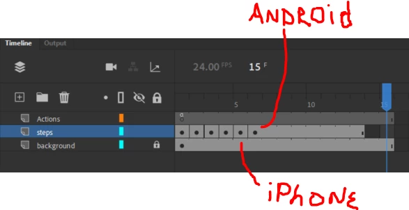

    I was able to get the code right so I can jump from one movie clip to another within a single scene. I am now running into a problem where I have two buttons (hotspots) in a scene. Each button instance has its own distinct name but otherwise the action for each button is nearly identical (See screenshot)
    As you can see, I have each button called out in the timeline. One is set to go to and stop on frame 5 of the main scene and the other is set to go to and stop on frame 6 (See main scene timeline below)
    The problem I am running into is when I got to preview the scene, it works until I get to the part where I choose one of the phones. Both hotspots are navigating to frame 6 (Android). Can someone tell me why this is happening?
    kglad
    September 22, 2020
    those are frames 4 and 5, not 5 and 6.  fix your code and retry.
    MongosWorld
    September 25, 2020
    Not sure why you would call out those frames as 4 and 5. When I manually move the timeline to each respective frame called out in my screen cap above, they are clearly indicated as 5 and 6. I tried what you suggested anyway and it did not work. Not sure why this is so difficult. Even my "Back" and "Next" buttons are not functioning properly. The "Next" button works, but the "Back" button does not while using the exact same code (But calling a different frame to navigate to in the main scene). I really need some help here!
