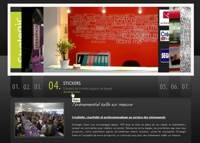

whith pictures, it will be easier for me to explain.
There are 7 slides numbered 01 thru 07
In this example I clicked on 04. The script pulled out the proper slide.

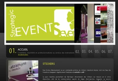

If I click on the link (where the pointer is), it does bring me to the right html page "stickers" in this case,

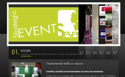

but the flash script of that banner is reinitialized to 01.
Originally from that script, it does get info from the page with the body id "page4" and the ?button=4

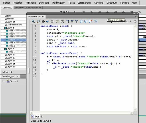

Here's what I have under Flash CS4
And as for documentation and proper identification of layers, pict and text, you're right it is null (txt_1, txt_2, txt_x...) !
