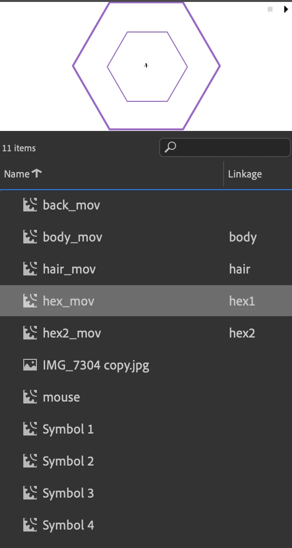

    AmarisGilAuthor
    February 6, 2021
    Thank you for replying,
    The instance of the hexagon that is supposed to appear is called "hex1" and it shows in the linkage in my library.
    Although, the hexagons still don't appear when I click.
    The background is called "back_mov" and the instance is called "back" although in my library it shows no linkage.
    Additional information that might be helpful to solve this problem:
    I created a cursor called "mouse" with the instance of "hex3" although in my library it shows no linkage.
    -Amaris
    AmarisGilAuthor
    February 6, 2021
    It seems like the hexagons do appear, but only on a specific area, this area is called "body_mov"
