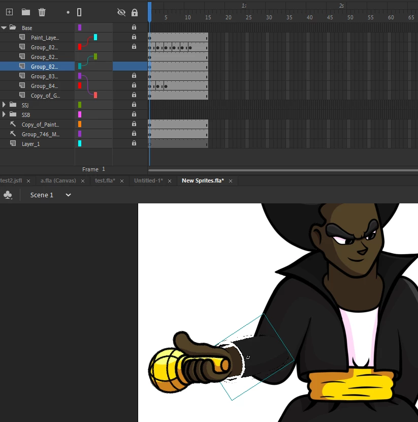

    Can you use the parental view to move the fore arm that is connected to to hand to see and press ctrl b if it's working or not?
    got a chance to test.
    first, you have to unparent the forearm and hand.
    then you can use trace bitmap to edit the forearm.
    then convert the forearm to a symbol
    then reparent.
    here's a screenshot of the edited forearm that's rotated (and the hand movement shows it's connected to the forearm).

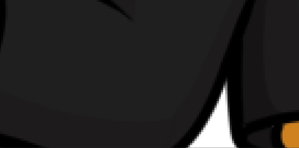

    edit: if anyone doesnt understand what i mean, its the darker pixels that i want to erase. from what i know, the only way to erase is to break apart
