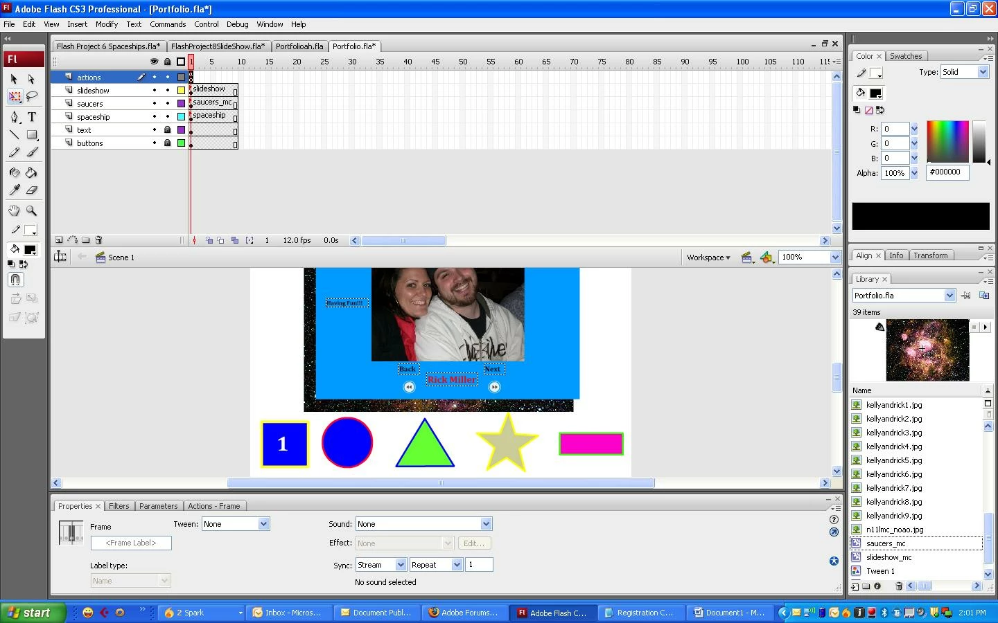

Thank you very much for responding. I am getting an error in the compiler panel:
1120: Access of undefined property saucers_mc            saucers_mc.play();
It's nice to know I'm on the right track! I saw a similar thread that you respnded to that seems to relate to what I am trying to do.
http://forums.adobe.com/thread/431340?tstart=0
Basically, I just need 5 buttons to trigger 5 MC's. So far I have 3 MC's on the same layer starting on differnt keyframes (1, 21, 41). The fisrt movie is a simple motion tween MC, the second is similar accept it has a motion guide on it, and the third is a slideshow with forward and back buttons nested inside it.
Rick
Ned Murphy
May 28, 2009
There are only a few possible causes for this problem when the code is right.  And the error message was nice enough to idenyify who's missing.  Either you haven't assigned an instance name to the movieclip (in the properties panel), or the movieclip isn't in the same place on the timeline as the code.  There is another possible problem, but check those first.
