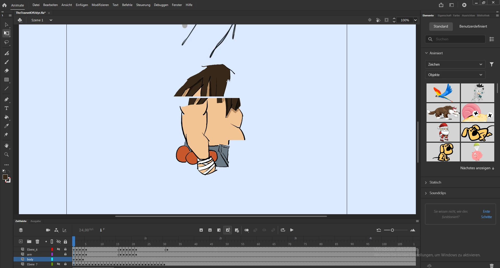

Hello everybody,
I have the following problem:
When I select a layer/object and move it, a part of it changes color. It is the same for all of the frames in that layer bot not for other layers. As soon as I move it, Adobe Animate changes the color of the one random part.
I even tried moving part of the layer/object, and it just seems to happen, when I move a certain part of the Object
In the Menue where you see the Working steps it just shows the moving of the object, not that it had filled in any color.
It just happened today, and never had happened in any other project.
I also never changed any of any settings. I've been using Animate like this for quite some time, and never had trouble with this.
Things I already tried:
Reopen the project
Deinstalling Animate and reinstalling it
Checking if I have the newest version (23.0.2)
I am unable to move that layer/Object now, without it changing color.
Does somebody has a solution for this?
Thanks in advance!

    Hi, here's 3 things you can try:
    • Put the contents inside a drawing object or symbol.
    • For messy drawings, try reducing the amount of vector points. Select the drawing and go to Modyfy > Shape > Optimize.
    • If this is a corrupted layer, try copy-pasting the contents into a new layer.

    Jun 2, 2023 7:07 PM UTC
    Copying it to another layer worked!
    Thank u very much
