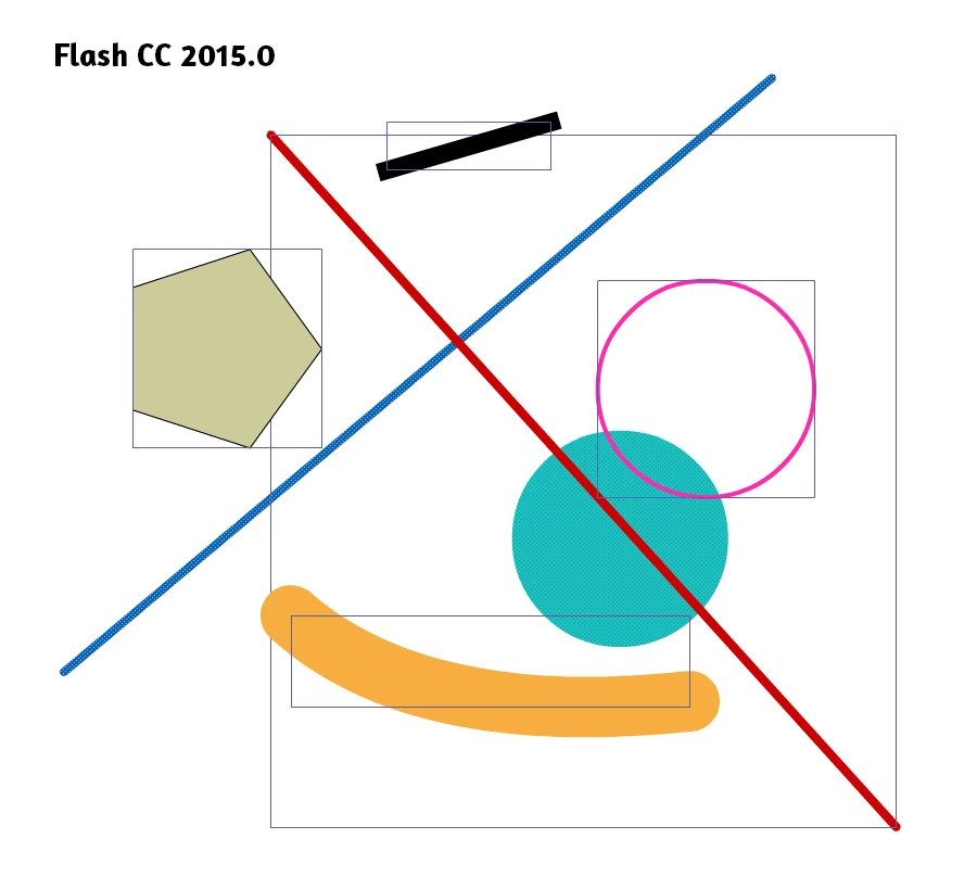

    The bounding box was very important for me and I'm surprised I don't see more people complaining about it missing.
    I already filed a feature request (without response) some months ago to bring it back as an option.
    I'll do it again with the images I attach here.

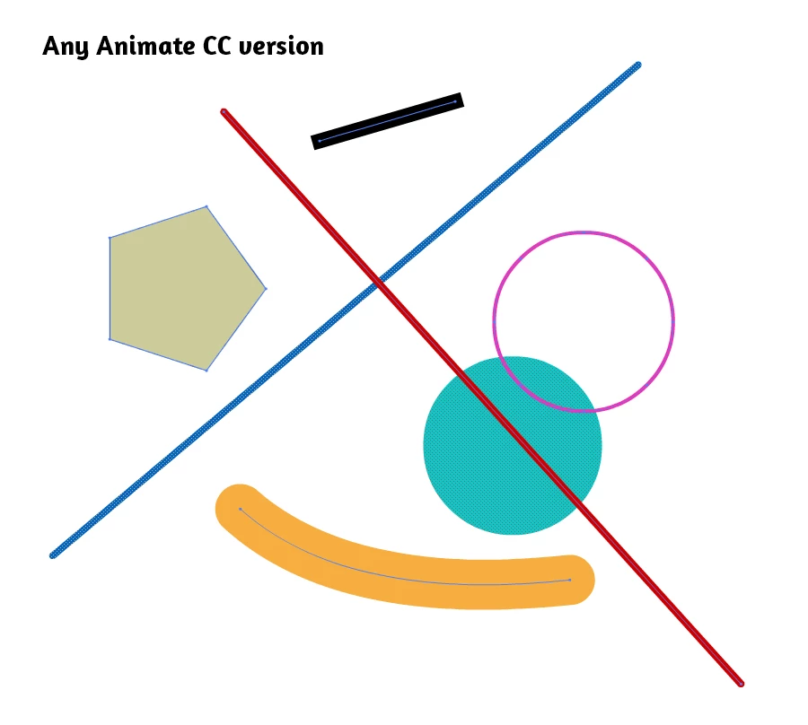

    Everything is perfectly visible and understandable at a glance. With
    The current selection is inferior in all ways. I barely see if anything is selected.
    And selection is practically invisible on any thin line drawing object. If the layer color is close to the line color it’s even worse.
    Also you simply can't see hairline thickness lines (note the pentagon shape)
    Compared to bounding boxes you can’t easily see what’s a “raw” vector line and what’s a drawing object. With a thinner line object it - again - gets impossible. It’s also very slow when I want to spot out the ones I’m searching for.

    It does still display the bounds of drawing objects when they're selected, just not in box form anymore (unless the object is indeed box-shaped). Instead it displays the object's vector control points, which can be manipulated directly with the subselection tool without having to double-click into the object.
