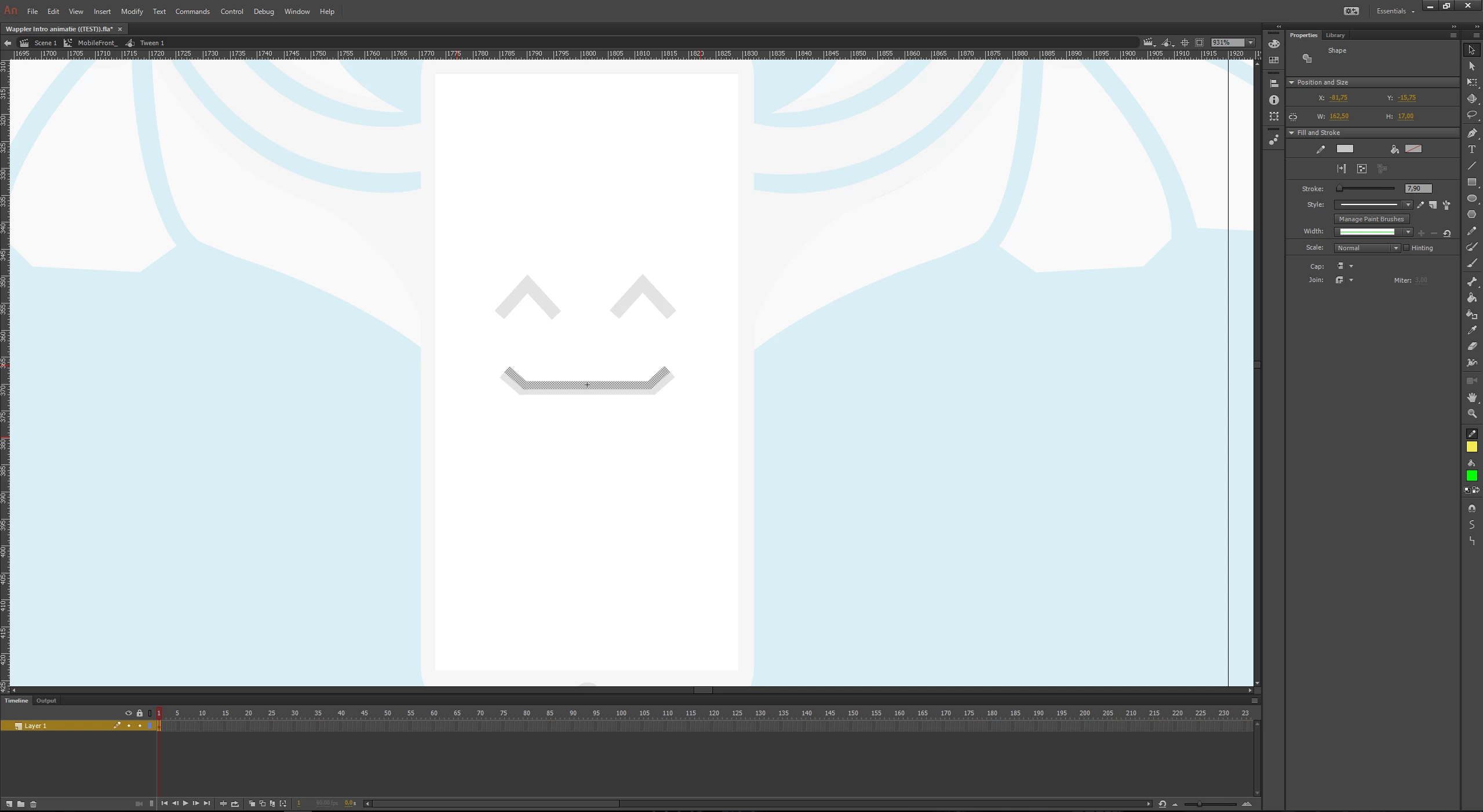

I'm working on an animation and I came across this strange issue. This is also my first time working with animation software so the answer might be right under my nose.
When I'm inside the file everything looks fine and the object (the smile) is like it should be.

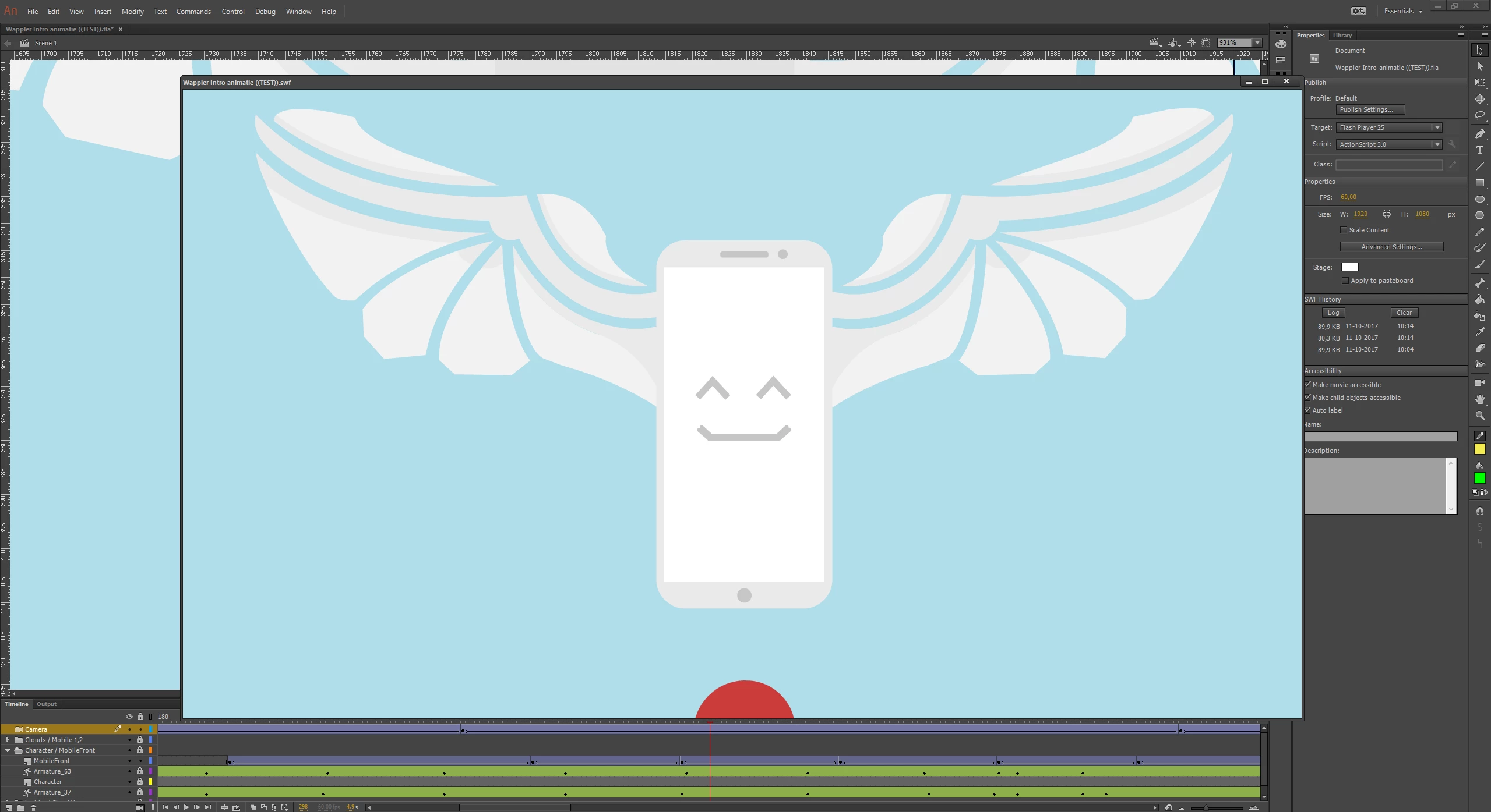

But when I press (CTRL+ENTER), the objects (the smile) automatically get rounded of.
Am I'm just oblivious to an easy fix? I just can't figure it out.

Look at the View menu, Preview Mode. You might be set to Fast, which will look different to when you do a test movie.
I think there are different rules with Windows about how lines end. Try using a Square cap instead of None.

My preview mode was set on Anti-Alias Text. I tried putting it on Full but I got the same result.
Next, I tried giving the symbols a square cap. Didn't seem to work either (Also looked if the result would differ in different viewmodes). Right clicking on the SWF also showed that it was set to High.
