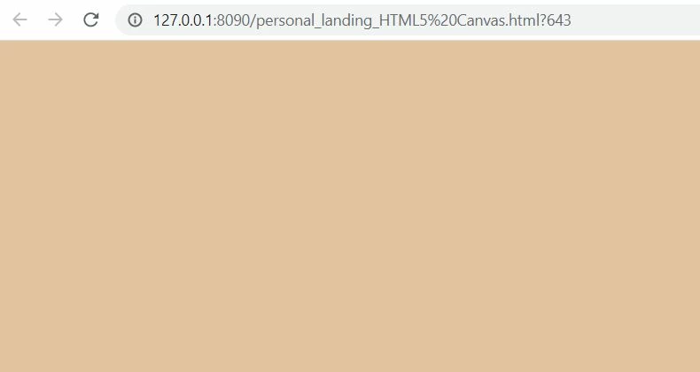

Occur a problem during testing html canvas in browser.
I have a problem in Adobe Animate,
discussed it with a specialist. Problem wasn't resolve.
And I just wondering what could be a problem.
My steps:
1. Open HTML5 Canvas.fla file and control menu -> test

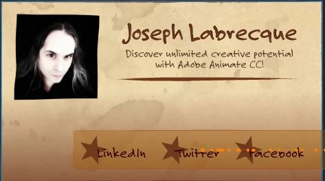

2. There are images in the file and animation
Results:
In browser opens blank html file without images and animation
Expected results: Should be open HTML file with animation and images.

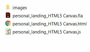

    Admirable_Echo5CFC
    April 27, 2020
    Guys, thanks for helping me.
    I notice folder with images is empty when I began testing. I don't know why.
    I sent file to help center - and they said it worked on their computers.
    I have adobe animate version 20.0.3 (Build 25487)
    1) What browser?
    google chrome
    2) Have you tried different browsers?
    mozilla firefox
    3) Does your project have any code?
    script
    4) Are you using tweened animation?
    yes

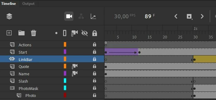

    There are some screenshots and script
