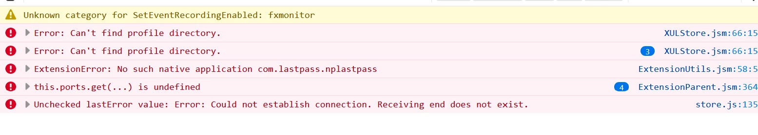

I tried disabling all the browser security setting to no avail. Then tried Firefox with these console errors:
Seems it is all about accessing the js correctly, but I don't know how to make this happen. Again, this project needs to run from the files I will publish and not online. What can I do to make that work?
