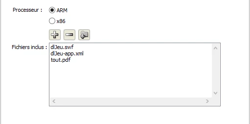

(Note : I've add the "tout.pdf" to my apk in the publish setting like that :
6 replies
