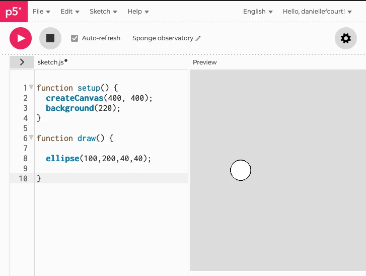

    ProfDrawAuthor
    Dec 2, 2021 4:37 PM UTC
    Thanks for the reply.
    Here's a sample. I can create this simple ellipse in p5.js
    When I add the code to AA it creates a new canvas, under the AA one.
    If I delete createCanvas it still doesn't render to AA canvas.
