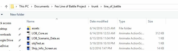

C:\Users\Vossie\Documents\Fex Line of Battle Project\trunk\line_of_battle\LOB_Core.as, Line 1, Column 1 5001: The name of package 'line_of_battle' does not reflect the location of this file. Please change the package definition's name inside this file, or move the file. C:\Users\Vossie\Documents\Fex Line of Battle Project\trunk\line_of_battle\LOB_Core.as
So I've checked:
package line_of_battle {
public class LOB_Core extends flash.display.MovieClip {
Filename is LOB_Core.as.
Path:

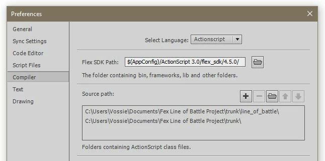

Class path:
Such a simple thing but I must be missing something since I keep getting the same error. I even created a new folder in a new location and created new test package parent class and child class with all new names carefully checked, and I get the exact same error. It keeps insisting my package name doesn't agree with the folder name even though that is clearly not the case.

your main file needs to be in trunk.  at least, that's how it would work with flash/animate.

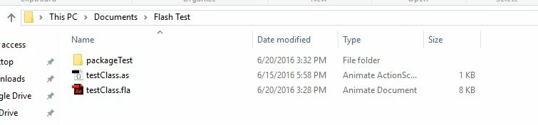

This does not seem to work either. I just created a folder called Flash Test and made a testClass.as and testClass.fla files inside. I gave the testClass the package name of packageTest. Then I created a folder called packageTest inside
packagepackageTest{
public class testClass {
C:\Users\Vossie\Documents\Flash Test\testClass.as, Line 1, Column 15001: The name of package 'packageTest' does not reflect the location of this file. Please change the package definition's name inside this file, or move the file. C:\Users\Vossie\Documents\Flash Test\testClass.as

there's a testClass.as file that is not in the packageTest folder.  fix that by deleting the testClass.as shown in your screenshot.
save a testClass.as with package equal to packageTest in the packageTest folder if there's not one there already.  retest.
