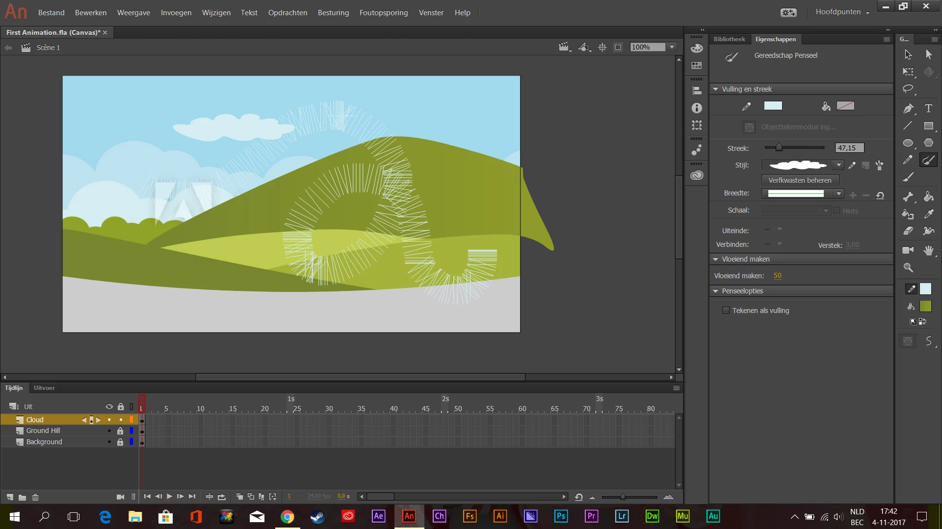

Whenever I draw a line with the paintbrush tool it first shows up as multiple vertical lines with some space between them before it converts into the line i actually drew once I stop drawing. The results are the same but it's quite annoying, does anyone know how to fix this?
What it looks like before I release the mouse/stop drawing

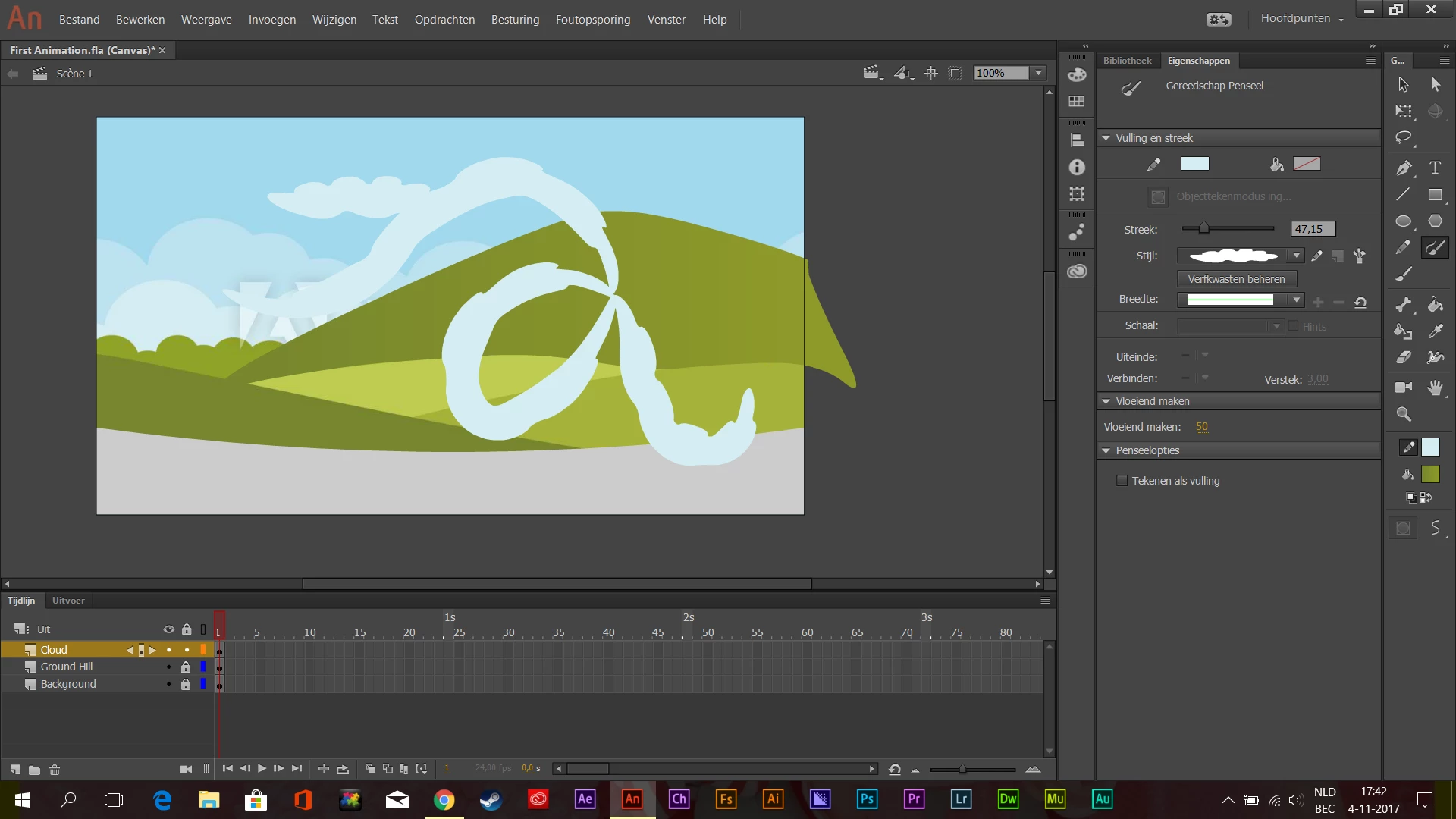

Once I release it it turns into this.

Correct answer Asymetrical
That's normal behavior for the Paint Brush tool but I would suggest you don't use the Paint Brush to draw... use the regular Brush tool. The Paint Brush tool is for a different purpose such as cleaning up and the preview lines are there on purpose. You can't get rid of them. You CAN however click the option to Draw as Fill and then the drawing is sped up a lot.
