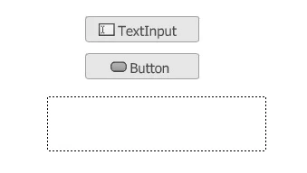

Hello, I'm a newbie whit Animate. This is a file HTML5Canvas.
I created 2 components (TextInput, Button) and a textdynamic box in my scene.

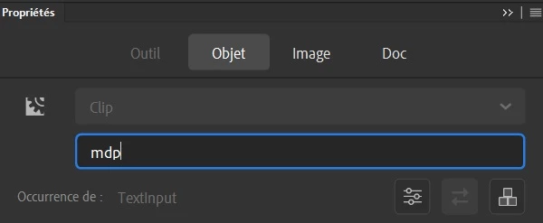

TextInput = mdp
Button = valider
The scene :
And I would like if the response is right when the user clicks the button, the text OK is displayed then redirected to a web page. And if the code is wrong, another text is displayed.

Looks like he can't make the connection with the ID of components.
