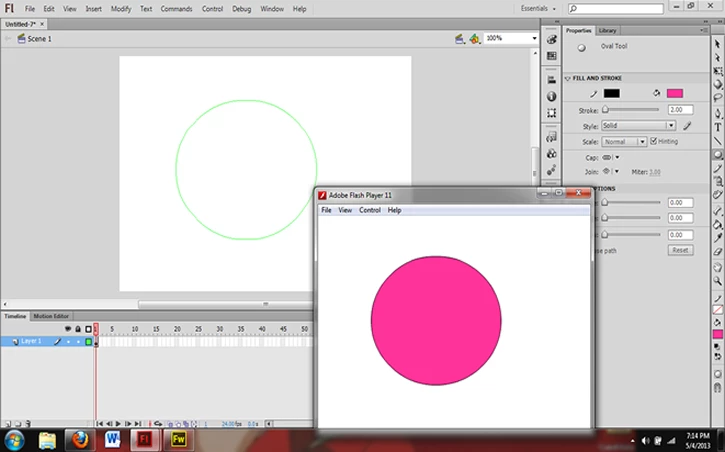

PLEASE HELP! My objects have no stroke/fill unless in publish preview. I can't see what I am doing?
  • May 4, 2013
  • 532 views
I have CS6 Flash Professional, Windows 7 Professional, File I am trying to make is an ActionScript 2. I have to use ActionScript 2 for it because it is a school project.  I can click the oval tool, set the stroke size to 2.0 stroke to black, fill to pink and drag to create the oval on the stage. while i am dragging, and when i finish dragging it is still just a thin green outline of an oval. No fill, no thickness to the stroke, and the only color it will be is green. When i click publish preview and load a preview for flash the pop up box shows the oval with 2.00 stroke size, black stroke, and pink fill.
It seems like no matter what I try to draw or make for the stage it just shows up as this green outline and wont display any of the stroke/fills that i select for them. Is this something in my settings that I need to change?
If someone could help me out it would be really, really appreciated!!!
Correct answer Ned Murphy
You appear to have things displaying in outline mode.  There are a couple of places/ways this can happen.
The first, more obvious place is on the timeline.  If you look at the layer you are drawing in, at the end of the section where you name the layer you should see a small square.  That square controls the outline mode for that layer.  I cannot tell from the image you show if it is active or not, so try clicking on it to switch it between outline and not outline mode to see if that fixes things.  The color inside the square will be a solid color if it is not in outline mode.
The second, less obvious place to look in via the top menu bar... select View -> Preview Mode -> and make sure Outlines is not selected.
May 4, 2013
I must have pressed that little box a thousand times on my own trying to fix it. but going to view preview mode and clicking full fixed it. you are a hero good sir now i can finish my final !!
