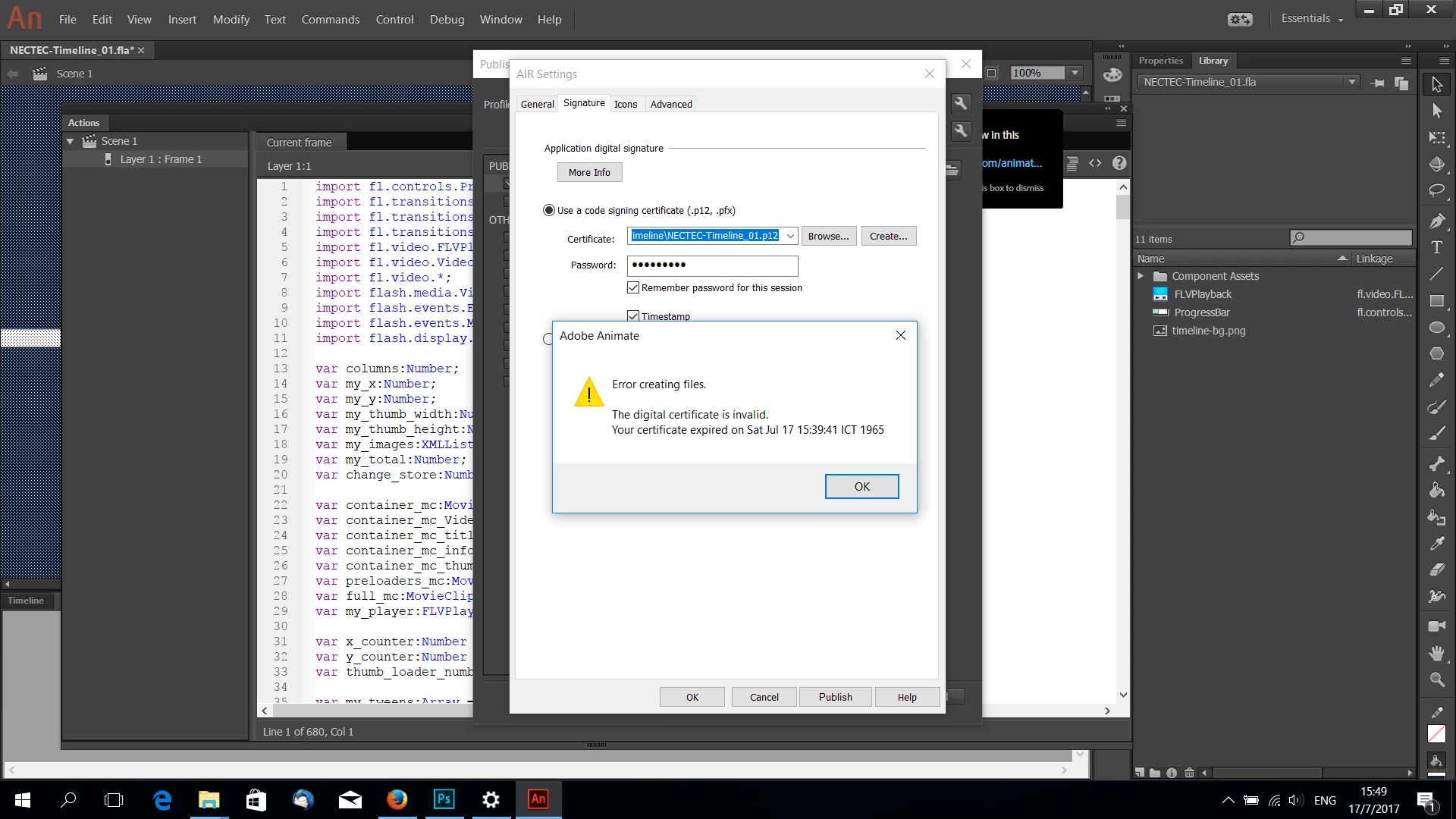

I try to export .air from AnimateCC but it show error like photo below. How could I solve this problem?

    The certificate may have problems, it expired in 1965. Check your system clock, in case something is wrong there, or find another copy of the certificate. If it's a new application you could generate a new certificate.
    Also, which version of AIR are you using? There were timestamp server issues for a while, and you would want to be using the release AIR 26, and also make sure you're up to date with Animate.

    Thank you for your help. Where could I find another copy of the certificate?
