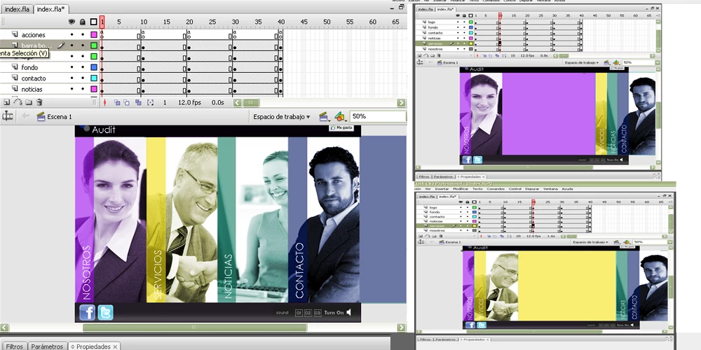

How are your buttons arranged along the timeline?
April 16, 2011
IS LIKE THIS. THE 4 COLOR IMAGES ARE THE BUTTONS.THE BIGGER PIC IS THE INDEX.
Ned Murphy
April 16, 2011
For the problem you say you are having, btn3 in the last keyframe would be the most suspect.  You need to check every keyframe for btn3 and make sure you have the instance name assigned.
Another thing you should do is not use gotoAndPlay if the intention is to gotoAndStop at those keyframes.  What will happen is if you click the same button twice using gotoAndPlay, it will play on to the next frame that tells it to stop.  Using gotoAndStop will solve that.
