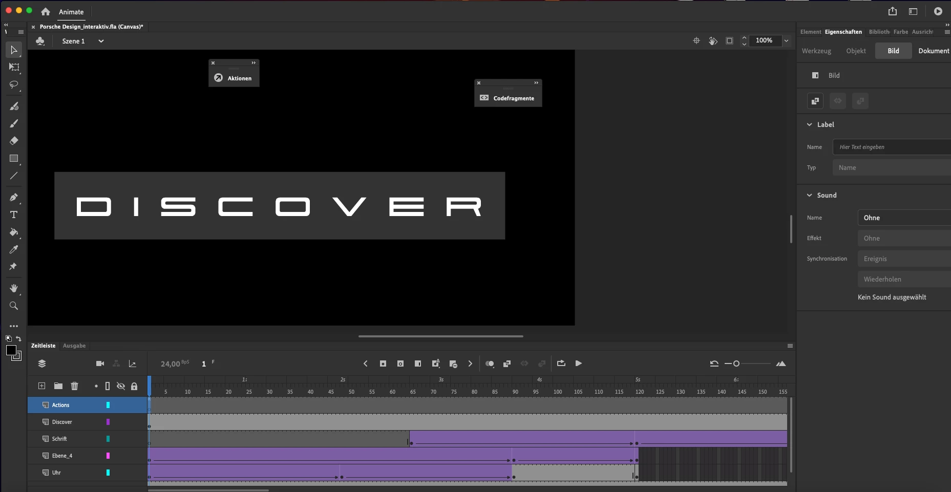

    1)
    1) This is my normal timeline. I dont know why i have an extra Layer for the actions - because i always click on my button Layer and then choose the actions. But it keeps jumping to a new Layer. I can do nothing against it.

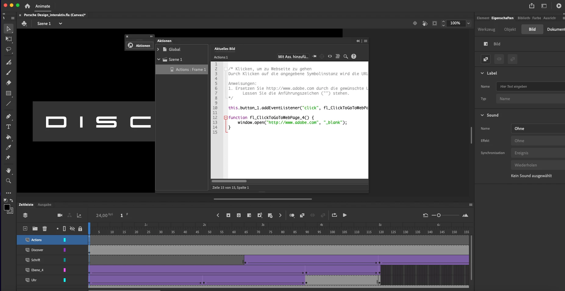

    3)
    3) This is my code.
