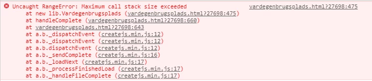

The browser console is logging this error:
Uncaught RangeError: Maximum call stack size exceeded
at new lib.Vardegenbrugsplads (vardegenbrugsplads.html?27698:475)
at handleComplete (vardegenbrugsplads.html?27698:660)
at vardegenbrugsplads.html?27698:643
at a.b._dispatchEvent (createjs.min.js:12)
at a.b.dispatchEvent (createjs.min.js:12)
at a.b._sendComplete (createjs.min.js:16)
at a.b._loadNext (createjs.min.js:17)
at a.b._processFinishedLoad (createjs.min.js:17)
at a.b._handleFileComplete (createjs.min.js:17)
This usually happens because of very large and / or complex timelines. Especially if motion tween is used.
For you to have an idea, take a look at part of the chain of tweens that has been generated for your timelines:
Some possible solutions are:
- Split up your timelines in different symbols;
- Replace motion tweens by classic tweens and guide layers.
Please let us know if this helps.
