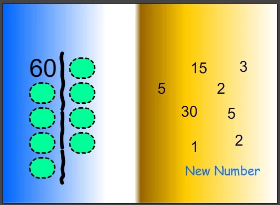

Random Frame
I have identified a button.
This button was going to the next frame.
But I want a random frame.
Would you like to see sample code.
thank you so much

    Thank you, AMULI but I am so bad in coding that I do not understand most of the writings.
    I will explain my problem;
    There were sample codes in Animate CC
    Random number generation code;
    function fl_GenerateRandomNumber_4(limit:Number):Number
    {    var randomNumber:Number = Math.floor(Math.random()*(limit+1));
         return randomNumber;
    trace(fl_GenerateRandomNumber_4(100));
    AND
    Next frame pass code;
    newnumber.addEventListener(MouseEvent.CLICK, fl_ClickToGoToNextFrame);
    function fl_ClickToGoToNextFrame(event:MouseEvent):void
    {  nextFrame();   }
    My question is;
    How do I add this code any button?
    For example, I have a button which name is "newnumber"
    and I want, when I click this button, it goes to random frame
