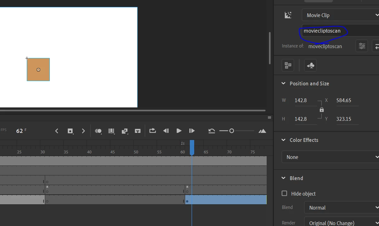

I have a simple script that checks if an object exists on the stage and returns that objects properties. However, this script only works during the first time the object is tested. If i delete the object from the stage, and add it back later on in the timeline, the object is no longer found.
Here is a code sample. Is there some way to delete the object and recreate it for the scanning feature to function?

    There should be no need to "scan" for your object existing. If you create the object at author time, give it an instance name, then you should be able to just check whether an object with that name exists. Likewise, if you dynamically create it at runtime, assign a property with its name to its container object.
