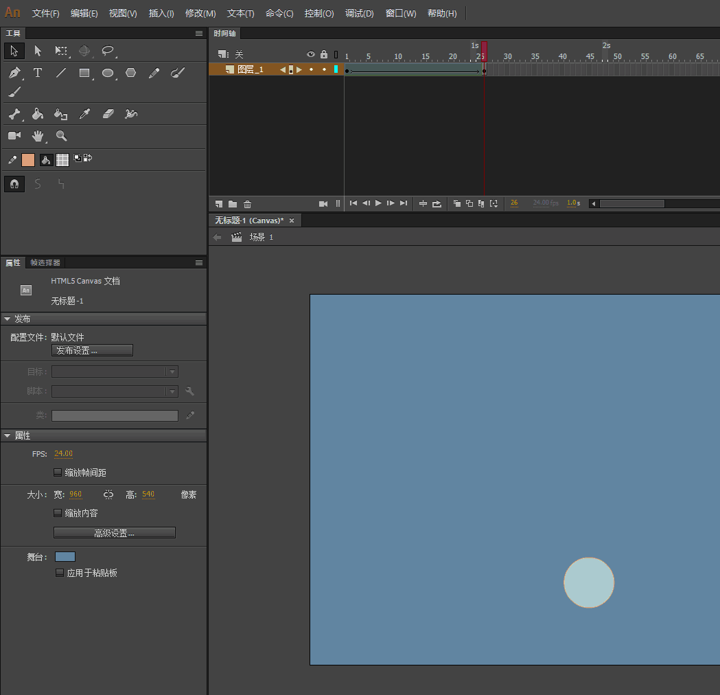

    Correct answer chenjil43641795
    Sorry, my English is not good, I may not understand what you mean.
    Do you want to shorten the playback time of the scene?
    Now the time divided by the time you want to get the playback.
    Then select zoom Frame Spacing
    FPS divided by the number of.
    FPS Input Value.
    Then cancel the zoom frame spacing
    FPS Enter the original value
    So the scene will change.
    If you are going to change the playback time of a layer.
    You can select the layer you want to drag
    If my understanding is wrong, please let me know.

    Colin Holgate
    May 28, 2018
    You can shorten the scene in two steps. You will need to calculate how much shorter you want it to be, then use the right numbers. For an easy example case, let's say that you want it to be about 16.666% shorter:
    1. Change the frame rate from 24 fps to 30 fps. That will then make the scene the length you want it, but the frame rate is name 30, and you want 24 in the end.
    2. After changing the frame rate to 30, check the box that says Scale Frame Spans. Change it back to 24 fps.
    You should then have the animation at 24 fps, but going a bit quicker than it did before.
    Be careful though, I think the steps will change the whole FLA, not just this scene. You could copy the frames into a new 24 fps FLA, do the changes, then copy the frames back into your main FLA.

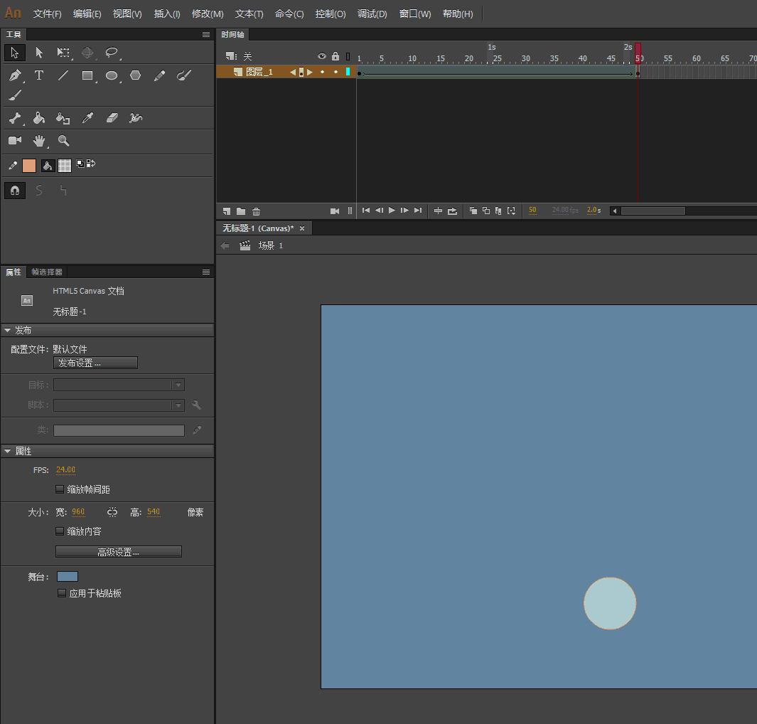

    chenjil43641795
    chenjil43641795Correct answer
    May 28, 2018
    FPS Input Value.
