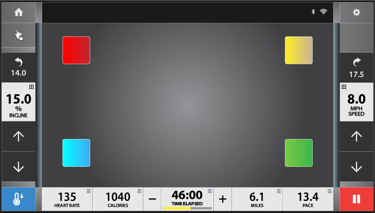

Dear all,
I have seen how brilliant and helpful you have been to users with some flash coding issues, and I hoped you may be able to help me.
I am creating an animation to display on a treadmill, including three counters which, rather than loop over a temporal cycle should continue infinitely. The 3 timers are:
(1) run timer starting from 46:00 minutes, resetting at 59:59.
(2) calories burning
(3) miles increase
2&3 being very similar and requiring only a variable of time delay between incremental figures. I hope you might be able to help me? Thanks for your time.

Thank you. Perhaps I may disturb you by admitting that I'm not entirely sure how to apply this. There is very little scope to my knowledge, and I would be humbled if anyone could provide a line-by-line code for the three dynamic texts. Forgive me!
FDTFQV65
FDTFQV65Author
October 25, 2018
PS. I am flexible. Try me at HTML or ActionScript, I will rise to the challenge. It will be exported as OAM for Adobe Muse imbedding.
