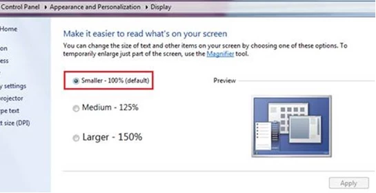

    Nov 29, 2016 12:53 PM UTC
    This may happen if your Text Scaling is not set to 100% on a HiDPI display machine.
    Can you please set it to 100% in Control Panel > Display section and see if that helps?
